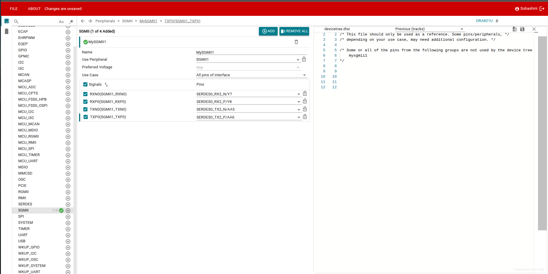

    Additionally, there have been updates to the TX and RX pin connections on our board. When we attempt to configure these TX/RX pins using the SysConfig tool, no corresponding entries are generated in the DTSI output. Now, we have only included the MDIO, MDC, and reset pins in the DTSI.
    SerDes pins are unique and not multiplexed with any other pins these are like SERDES0_TXy_P/N and SERDES0_RXy_P/N.
    The selection of SerDes lane is depends upon the serdes_ln_ctrl node in device tree.
    Also, note that 10G is supported only from MAC Port-1 on Silicon Revision 2 SoC.
    SGMII1 lines are from SERDES0_RX2 and SERDES0_TX2 pins.
    As mentioned above SerDes pins are not multiplexed with any other pins so, no pin-mux configuration is required.

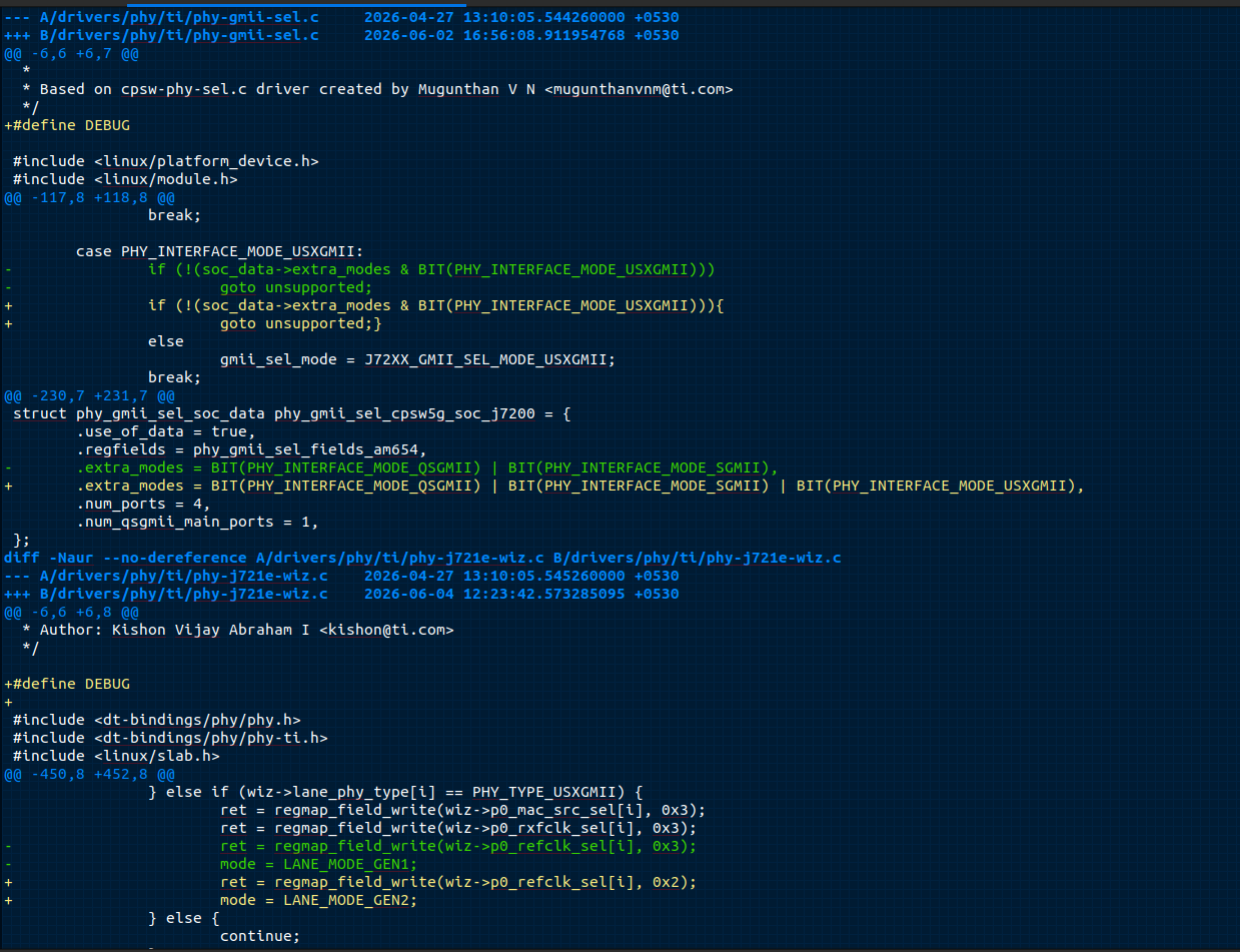

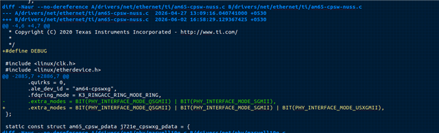

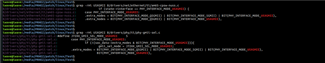

  • Hi Sudheer,
    As per the reference link you shared, we have updated the DTSI entries and the driver file. However, after these changes, the Ethernet nodes are no longer being detected.
    In our setup, both Eth0 (1 Gbps) and Eth1 (10 Gbps) share the same MDC and MDIO pins. After applying the DTSI changes, even Eth0 has stopped working and is not being detected.
    We need to validate the 10G PHY through board-to-board testing. Could you please guide us on how to resolve this issue?
    For your reference, we have attached the updated DTSI files and test logs.
    Details:
    SDK Version: 09.02.00.04
    Yocto: Kirkstone
    SoC: DRA821
    Interface Mode: USXGMII / XFI (10G fixed link)
    10G part number: 88X3310-A1-BUS4I000
    0777.files.zip3482.testlog.txt

    // SPDX-License-Identifier: GPL-2.0
     * Copyright (C) 2024-2025 iwave Global Technologies Pvt Ltd.
    /dts-v1/;
    #include "k3-j7200-iwg52m.dtsi"
    #include <dt-bindings/gpio/gpio.h>
    #include <dt-bindings/interrupt-controller/irq.h>
    #include <dt-bindings/net/ti-dp83867.h>
    #include <dt-bindings/mux/ti-serdes.h>
    #include <dt-bindings/phy/phy.h>
    	chosen {
    		stdout-path = "serial2:115200n8";
    		bootargs = "console=ttyS2,115200n8 earlycon=ns16550a,mmio32,0x02800000";
            aliases {
                    i2c0 = &wkup_i2c0;
                    i2c1 = &mcu_i2c0;
    		ethernet0 = &cpsw0_port3;
    		ethernet1 = &cpsw0_port2;
    		ethernet2 = &cpsw0_port1;
    	vdd_sd_dv: gpio-regulator-TLV71033 {
    		/* Output of TLV71033 */
    		compatible = "regulator-gpio";
    		regulator-name = "tlv71033";
    		pinctrl-names = "default";
    		pinctrl-0 = <&vdd_sd_dv_pins_default>;
    		regulator-min-microvolt = <1800000>;
    		regulator-max-microvolt = <3300000>;
    		regulator-boot-on;
    		gpios = <&wkup_gpio0 84 0>;
    		gpios-states = <0>;
    		states = <1800000 0x1>,
    			 <3300000 0x0>;
    	iwg52m_info {
    		compatible = "iwave,iwg52m-info";
    &wkup_pmx0 {
    	b7_pins_default: b7-pins-default {
    	pinctrl-single,pins = <
                    J721E_WKUP_IOPAD(0x8, PIN_OUTPUT, 2) /* (B7)*/
            som_eeprom_pins_default: som-eeprom-pins-default {
                            J721E_WKUP_IOPAD(0x24, PIN_INPUT, 7) /*A8 eeprom write protect gpio for Som*/
    	VU9p_pins_default_prog_pins_default: VU9p-pins-default-prog-pins-default {
                            J721E_WKUP_IOPAD(0x28, PIN_OUTPUT, 7) /*WKUP_GPIO0_26*/
    &wkup_pmx1 {
            d5_pins_default: d5-pins-default {
                    J721E_WKUP_IOPAD(0x4, PIN_OUTPUT, 7) /* (D5)*/
    &wkup_pmx2 {
    	mcu_uart0_pins_default: mcu-uart0-default-pins {
    			J721E_WKUP_IOPAD(0x8c, PIN_INPUT, 0) /* (D20) MCU_UART0_RXD */
    			J721E_WKUP_IOPAD(0x88, PIN_OUTPUT, 0) /* (D19) MCU_UART0_TXD */
    	spi_pins_default: spi-pins-default {
    		J721E_WKUP_IOPAD(0x58, PIN_INPUT, 0) /* (B18) WKUP_GPIO0_0.MCU_SPI1_CLK */
    		J721E_WKUP_IOPAD(0x5c, PIN_OUTPUT, 0) /* (B19) WKUP_GPIO0_1.MCU_SPI1_D0 */
    		J721E_WKUP_IOPAD(0x60, PIN_INPUT, 1) /* (D14) WKUP_GPIO0_2.MCU_SPI1_D1 */
    		J721E_WKUP_IOPAD(0x06c, PIN_OUTPUT, 2) /* (B16) WKUP_GPIO0_5 TPM CS*/
    	vu_pmic2_pins_default: vu-pmic2-pins-default {
    		J721E_WKUP_IOPAD(0x54, PIN_INPUT, 7) /*A17*/
    	ps_gpio_header_uart_pins_default: ps-gpio-header-uart-pins-default {
    		J721E_WKUP_IOPAD(0x90, PIN_INPUT, 7) /*E20*/
    		J721E_WKUP_IOPAD(0x94, PIN_INPUT, 7) /*E21*/
    &wkup_pmx3 {
          	 vdd_sd_dv_pins_default: vdd-sd-dv-pins-default {
                    	J721E_WKUP_IOPAD(0x1C, PIN_OUTPUT, 7) /*E18 */
    &main_pmx0 {
    	main_uart0_pins_default: main-uart0-default-pins {
    			J721E_IOPAD(0xb0, PIN_INPUT, 0) /* (T16) UART0_RXD */
    			J721E_IOPAD(0xb4, PIN_OUTPUT, 0) /* (T17) UART0_TXD */
    	VU9p_pins_default_done: VU9p-default-pins {
    			J721E_IOPAD(0xd8, PIN_INPUT, 7) /* (W2) MAIN_GPIO0_57 */
    	main_mmc1_pins_default: main-mmc1-pins-default {
    			J721E_IOPAD(0x104, PIN_INPUT, 0) /* (M20) MMC1_CMD */
    			J721E_IOPAD(0x100, PIN_OUTPUT, 0) /* (P21) MMC1_CLK */
    			J721E_IOPAD(0xfc, PIN_INPUT, 0) /* (P25) MMC1_CLKLB */
    			J721E_IOPAD(0xf8, PIN_INPUT, 0) /* (M19) MMC1_DAT0 */
    			J721E_IOPAD(0xf4, PIN_INPUT, 0) /* (N21) MMC1_DAT1 */
    			J721E_IOPAD(0xf0, PIN_INPUT, 0) /* (N20) MMC1_DAT2 */
    			J721E_IOPAD(0xec, PIN_INPUT, 0) /* (N19) MMC1_DAT3 */
    			J721E_IOPAD(0xe4, PIN_INPUT, 8) /* (V1) TIMER_IO0.MMC1_SDCD */
    	main_cpsw_pins_default: main-cpsw-pins-default {
    			J721E_IOPAD(0x4c, PIN_INPUT, 4) /* (V19) MCAN5_RX.RGMII3_RD0 */
    			J721E_IOPAD(0x50, PIN_INPUT, 4) /* (T13) MCAN6_TX.RGMII3_RD1 */
    			J721E_IOPAD(0x54, PIN_INPUT, 4) /* (U14) MCAN6_RX.RGMII3_RD2 */
    			J721E_IOPAD(0x58, PIN_INPUT, 4) /* (U16) MCAN7_TX.RGMII3_RD3 */
    			J721E_IOPAD(0x48, PIN_INPUT, 4) /* (V21) MCAN5_TX.RGMII3_RXC */
    			J721E_IOPAD(0x5c, PIN_INPUT, 4) /* (U15) MCAN7_RX.RGMII3_RX_CTL */
    			J721E_IOPAD(0x60, PIN_OUTPUT, 4) /* (T15) MCAN8_TX.RGMII3_TD0 */
    			J721E_IOPAD(0x64, PIN_OUTPUT, 4) /* (U19) MCAN8_RX.RGMII3_TD1 */
    			J721E_IOPAD(0x68, PIN_OUTPUT, 4) /* (T14) MCAN9_TX.RGMII3_TD2 */
    			J721E_IOPAD(0x6c, PIN_OUTPUT, 4) /* (U18) MCAN9_RX.RGMII3_TD3 */
    			J721E_IOPAD(0x74, PIN_OUTPUT, 4) /* (U20) MCAN10_RX.RGMII3_TXC */
    			J721E_IOPAD(0x70, PIN_OUTPUT, 4) /* (U17) MCAN10_TX.RGMII3_TX_CTL */
    	main_mdio_pins_default: main-mdio1-pins-default{
    			J721E_IOPAD(0xa8, PIN_OUTPUT, 5) /* (W19) UART8_TXD.MDIO0_MDC */
    			J721E_IOPAD(0xa4, PIN_INPUT, 5) /* (W14) UART8_RXD.MDIO0_MDIO */
    	eth_reset_pins_default: gpio0-default-pins {
    			J721E_IOPAD(0xd4, PIN_INPUT, 7) /* (V3) I2C0_SCL.GPIO0_56 */
    	Eth_10G_reset_pins_default: Eth-10G-reset-pins-default {
                            J721E_IOPAD(0xE0, PIN_INPUT, 7) /* (T3)*/
    	typec_irq_pins_default: typec-irq-pins-default {
                    J721E_IOPAD(0xc4, PIN_INPUT_PULLUP, 7) /* (U5) MAIN_GPIO0_52 */
    	vu_pmic1_pins_default: vu-pmic1-pins-default {
    			J721E_IOPAD(0x1c, PIN_OUTPUT, 7) /*AA19*/
    	RGMII2_pins_default: RGMII2-pins-default {
    			J721E_IOPAD(0x28, PIN_OUTPUT, 4) /*(W21) RGMII2_TXC/MCAN1_TX/RMII2_TX_EN/SPI6_CS0/EHRPWM_SOCA/GPMC0_A3/MCASP0_AXR11/GPIO0_11*/
    			J721E_IOPAD(0xa0, PIN_OUTPUT, 4) /*(U21) RGMII2_TX_CTL/GPIO0_41/RMII2_TXD0/SPI6_D1/UART4_RXD/GPMC0_A13/MCASP2_ACLKX */
    			J721E_IOPAD(0x90, PIN_OUTPUT, 4) /*(W17) RGMII2_TD0/MCAN15_TX/RMII2_RXD0/GPIO0_37/SPI6_CS2/EQEP1_S/GPMC0_CSN2/GPMC0_A0/GPMC0_A21/MCASP2_AXR1*/
    			J721E_IOPAD(0x94, PIN_OUTPUT, 4) /*(W20) RGMII2_TD1/MCAN15_RX/RMII2_RXD1/SPI6_CS3/EQEP1_I/GPMC0_A15/GPMC0_ADVN_ALE/GPIO0_38/MCASP2_AXR2 */
    			J721E_IOPAD(0x98, PIN_OUTPUT, 4) /*(V14) RGMII2_TD2/UART2_RXD/RMII2_CRS_DV/SPI6_CLK/GPMC0_CLKOUT/GPMC0_FCLK_MUX/OBSCLK2/GPIO0_39/MCASP2_AXR3*/
    			J721E_IOPAD(0x9c, PIN_OUTPUT, 4) /*(V13) RGMII2_TD3/UART2_TXD/RMII2_RX_ER/GPIO0_40/SPI6_D0/MCASP2_AFSX */
    			J721E_IOPAD(0x78, PIN_INPUT, 4) /*(Y14)  RGMII2_RXC/MCAN11_TX/SPI2_CS0/EQEP0_A/SPI0_CS2/UART3_RXD/MCASP0_AXR13/GPMC0_A11/UART0_DTRN/GPIO0_31*/
    			J721E_IOPAD(0x8c, PIN_INPUT, 4) /*(AA16) RGMII2_RX_CTL/MCAN13_RX/GPMC0_CSN3/GPIO0_36/SPI2_D1/EQEP0_I/I2C5_SDA/UART8_RTSN/I3C0_SDA/GPMC0_A20/MCASP2_AXR0 */
    			J721E_IOPAD(0x7c, PIN_INPUT, 4) /*(Y13)  RGMII2_RD0/MCAN11_RX/SPI2_CS1/EQEP0_B/UART3_TXD/MCASP0_AXR14/GPMC0_A12/UART0_RIN/GPIO0_32 */
    			J721E_IOPAD(0x80, PIN_INPUT, 4) /*(AA15) RGMII2_RD1/GPIO0_33/SPI2_CS2/EQEP1_A/I2C6_SCL/UART2_RXD/MCASP0_AXR15/GPMC0_BE1N/GPMC0_A17/MCAN12_TX */
    			J721E_IOPAD(0x84, PIN_INPUT, 4) /*(AA14) RGMII2_RD2/GPIO0_34/SPI2_CS3/EQEP1_B/I2C6_SDA/UART2_TXD/MCASP1_AXR8/I3C0_SDAPULLEN/GPMC0_A18/MCAN12_RX */
    			J721E_IOPAD(0x88, PIN_INPUT, 4) /*(AA18) RGMII2_RD3/MCAN13_TX/GPMC0_WPN/SPI2_D0/EQEP0_S/I2C5_SCL/UART8_CTSN/MCASP1_AXR9/I3C0_SCL/GPMC0_A19/GPIO0_35 */
    	main_uart1_pins_default: main-uart1-default-pins {
    			J721E_IOPAD(0xbc, PIN_OUTPUT, 0) /* (T20) UART1_TXD.MCAN17_RX */
    			J721E_IOPAD(0xb8, PIN_INPUT, 0) /* (T18) UART1_RXD.MCAN17_TX */
    	pcie_rst_pins_default: pcie-rst-pins-default {
    			J721E_IOPAD(0x44, PIN_INPUT, 7) /*Y20*/
    	ps_gpio_header_pins_default: ps-gpio-header-pins-default {
    			J721E_IOPAD(0x20, PIN_INPUT, 7) /* (V18) MCAN0_TX.GPIO0_9 */
    			J721E_IOPAD(0x24, PIN_INPUT, 7) /* (V20) MCAN0_RX.GPIO0_10 */
    			J721E_IOPAD(0x38, PIN_INPUT, 7) /* (Y21) MCAN3_TX.GPIO0_15 */
    			J721E_IOPAD(0x3c, PIN_INPUT, 7) /* (W16) MCAN3_RX.GPIO0_16 */
    	tpm_reset_pins_default: tpm-reset-pins-default {
    			J721E_IOPAD(0x0c0, PIN_OUTPUT_PULLUP, 7)
    &main_pmx2 {
    	main_usbss0_pins_default: main-usbss0-pins-default {
    			J721E_IOPAD(0x04, PIN_OUTPUT, 0) /* (T4) USB0_DRVVBUS */
    &mcu_uart0 {
    	status = "okay";
    	/* Default pinmux */
    	pinctrl-0 = <&mcu_uart0_pins_default>;
    &main_uart0 {
    	status = "okay";
    	/* Shared with ATF on this platform */
    	power-domains = <&k3_pds 146 TI_SCI_PD_SHARED>;
    	pinctrl-0 = <&main_uart0_pins_default>;
    &main_uart1 {
    	status = "okay";
            pinctrl-0 = <&main_uart1_pins_default>;
    &main_uart2 {
    	/* MAIN UART 2 is used by R5F firmware */
    	status = "reserved";
    &main_gpio0 {
    	status = "okay";
    	pinctrl-0 = <&eth_reset_pins_default &Eth_10G_reset_pins_default &ps_gpio_header_pins_default &VU9p_pins_default_done &tpm_reset_pins_default>;
    	10G_reset_gpio {
    		gpio-hog;
    		gpios = <59 GPIO_ACTIVE_HIGH>;
    		output-high;
    		linename = "10G_rst";
    &main_gpio2 {
    	status = "disabled";
    &main_gpio4 {
    &main_gpio6 {
    &wkup_gpio0 {
    	pinctrl-0 = <&ps_gpio_header_uart_pins_default &VU9p_pins_default_prog_pins_default>;
    &wkup_gpio1 {
    &cpsw0 {
    	status = "okay";
    	pinctrl-0 = <&main_cpsw_pins_default &RGMII2_pins_default>;
    &davinci_mdio{
    &mcu_cpsw{
    &cpsw_port1 {
    &cpsw5g_mdio {
    	status = "okay";
    	pinctrl-0 = <&main_mdio_pins_default>;
    	phy3: ethernet-phy@3 {
    		reg = <3>;
    		compatible = "ethernet-phy-ieee802.3-c22";
            phy1: ethernet-phy@1 {
                    reg = <1>;
    		compatible = "ethernet-phy-ieee802.3-c45";
    		device_type = "ethernet-phy";
    		host-in-si1;
    &cpsw0_port3 {
    	status = "okay";
    	phy-mode = "rgmii-id";
    	phy-handle = <&phy3>;
    	phys = <&cpsw0_phy_gmii_sel 3>;
    &cpsw0_port1 {
    	status = "okay";
    	phy-mode = "usxgmii";
    	mac-address = [00 00 00 00 00 00];
    	phys = <&cpsw0_phy_gmii_sel 1>, <&serdes0_usxgmii_link>;

  • HI Sudheer,
    I have checked both drivers, and both contain the USXGMII flag entry. Also, I connected phy1 to the 10G node, but I am still seeing the “unknown device” and timeout issues.
    I am currently using SDK version 09_02_00_04. Does this SDK version support 10G implementation? If it does, could you please guide us on implementing 10G on our custom DRA821U board using this SDK version?
    Our board supports both x2 PCIe and 10G interfaces. We are using the Marvell 10G PHY (88X3310-A1-BUS4I000) on our board.
    I have also attached the Marvell driver changes. Can I keep those changes, or are any modifications required? Please confirm.
    Additionally, I have attached the DTSI files and driver change images for your reference.

    diff -Naur --no-dereference A/drivers/net/phy/marvell10g.c B/drivers/net/phy/marvell10g.c
    --- A/drivers/net/phy/marvell10g.c	2026-04-27 13:09:16.258744000 +0530
    +++ B/drivers/net/phy/marvell10g.c	2026-04-27 15:00:38.968908000 +0530
    @@ -25,6 +25,7 @@
     #include <linux/bitfield.h>
     #include <linux/ctype.h>
     #include <linux/delay.h>
    +#include <linux/firmware.h>
     #include <linux/hwmon.h>
     #include <linux/marvell_phy.h>
     #include <linux/phy.h>
    @@ -50,6 +51,14 @@
     	MV_PMA_21X0_PORT_CTRL_MACTYPE_10GBASER_RATE_MATCH	= 0x6,
     	MV_PMA_BOOT		= 0xc050,
     	MV_PMA_BOOT_FATAL	= BIT(0),
    +	MV_PMA_BOOT_PRGS_MASK	= 0x0006,
    +	MV_PMA_BOOT_PRGS_INIT	= 0x0000,
    +	MV_PMA_BOOT_PRGS_WAIT	= 0x0002,
    +	MV_PMA_BOOT_PRGS_CSUM	= 0x0004,
    +	MV_PMA_BOOT_PRGS_JRAM	= 0x0006,
    +	MV_PMA_BOOT_APP_STARTED	= BIT(4),
    +	MV_PMA_BOOT_APP_LOADED	= BIT(6),
     	MV_PCS_BASE_T		= 0x0000,
     	MV_PCS_BASE_R		= 0x1000,
    @@ -96,6 +105,13 @@
     	MV_PCS_PORT_INFO_NPORTS_MASK	= 0x0380,
     	MV_PCS_PORT_INFO_NPORTS_SHIFT	= 7,
    +	/* Firmware downloading */
    +	MV_PCS_FW_ADDR_LOW	= 0xd0f0,
    +	MV_PCS_FW_ADDR_HIGH	= 0xd0f1,
    +	MV_PCS_FW_DATA		= 0xd0f2,
    +	MV_PCS_FW_CSUM		= 0xd0f3,
     	/* SerDes reinitialization 88E21X0 */
     	MV_AN_21X0_SERDES_CTRL2	= 0x800f,
     	MV_AN_21X0_SERDES_CTRL2_AUTO_INIT_DIS	= BIT(13),
    @@ -148,6 +164,7 @@
     	int (*set_mactype)(struct phy_device *phydev, int mactype);
     	int (*select_mactype)(unsigned long *interfaces);
     	int (*init_interface)(struct phy_device *phydev, int mactype);
    +	const char *firmware_path;
     #ifdef CONFIG_HWMON
     	int (*hwmon_read_temp_reg)(struct phy_device *phydev);
    @@ -499,6 +516,134 @@
     	.module_insert = mv3310_sfp_insert,
    +struct mv3310_fw_hdr {
    +	struct {
    +		u32 size;
    +		u32 addr;
    +		u16 csum;
    +	} __packed data;
    +	u8 flags;
    +#define MV3310_FW_HDR_DATA_ONLY BIT(6)
    +	u8 port_skip;
    +	u32 next_hdr;
    +	u16 csum;
    +	u8 pad[14];
    +} __packed;
    +static int mv3310_load_fw_sect(struct phy_device *phydev,
    +			       const struct mv3310_fw_hdr *hdr, const u8 *data)
    +	int err = 0;
    +	size_t i;
    +	u16 csum;
    +	dev_dbg(&phydev->mdio.dev, "Loading %u byte %s section at 0x%08x\n",
    +		hdr->data.size,
    +		(hdr->flags & MV3310_FW_HDR_DATA_ONLY) ? "data" : "executable",
    +		hdr->data.addr);
    +	for (i = 0, csum = 0; i < hdr->data.size; i++)
    +		csum += data[i];
    +	if ((u16)~csum != hdr->data.csum) {
    +		dev_err(&phydev->mdio.dev, "Corrupt section data\n");
    +		return -EINVAL;
    +	phy_lock_mdio_bus(phydev);
    +	/* Any existing checksum is cleared by a read */
    +	__phy_read_mmd(phydev, MDIO_MMD_PCS, MV_PCS_FW_CSUM);
    +	__phy_write_mmd(phydev, MDIO_MMD_PCS, MV_PCS_FW_ADDR_LOW,  hdr->data.addr & 0xffff);
    +	__phy_write_mmd(phydev, MDIO_MMD_PCS, MV_PCS_FW_ADDR_HIGH, hdr->data.addr >> 16);
    +	for (i = 0; i < hdr->data.size; i += 2) {
    +		__phy_write_mmd(phydev, MDIO_MMD_PCS, MV_PCS_FW_DATA,
    +				(data[i + 1] << 8) | data[i]);
    +	csum = __phy_read_mmd(phydev, MDIO_MMD_PCS, MV_PCS_FW_CSUM);
    +		dev_err(&phydev->mdio.dev, "Download failed\n");
    +		err = -EIO;
    +		goto unlock;
    +	if (hdr->flags & MV3310_FW_HDR_DATA_ONLY)
    +		goto unlock;
    +	__phy_modify_mmd(phydev, MDIO_MMD_PMAPMD, MV_PMA_BOOT, 0, MV_PMA_BOOT_APP_LOADED);
    +	mdelay(200);
    +	if (!(__phy_read_mmd(phydev, MDIO_MMD_PMAPMD, MV_PMA_BOOT) & MV_PMA_BOOT_APP_STARTED)) {
    +		dev_err(&phydev->mdio.dev, "Application did not startup\n");
    +		err = -ENODEV;
    +unlock:
    +	phy_unlock_mdio_bus(phydev);
    +	return err;
    +static int mv3310_load_fw(struct phy_device *phydev)
    +	const struct mv3310_chip *chip = to_mv3310_chip(phydev);
    +	const struct firmware *fw;
    +	struct mv3310_fw_hdr hdr;
    +	const u8 *sect;
    +	size_t i;
    +	u16 csum;
    +	int err;
    +	if (!chip->firmware_path)
    +		return -EOPNOTSUPP;
    +	err = request_firmware(&fw, chip->firmware_path, &phydev->mdio.dev);
    +	if (err)
    +		return err;
    +	if (fw->size & 1) {
    +		err = -EINVAL;
    +		goto release;
    +	for (sect = fw->data; (sect + sizeof(hdr)) < (fw->data + fw->size);) {
    +		memcpy(&hdr, sect, sizeof(hdr));
    +		hdr.data.size = cpu_to_le32(hdr.data.size);
    +		hdr.data.addr = cpu_to_le32(hdr.data.addr);
    +		hdr.data.csum = cpu_to_le16(hdr.data.csum);
    +		hdr.next_hdr = cpu_to_le32(hdr.next_hdr);
    +		hdr.csum = cpu_to_le16(hdr.csum);
    +		for (i = 0, csum = 0; i < offsetof(struct mv3310_fw_hdr, csum); i++)
    +			csum += sect[i];
    +		if ((u16)~csum != hdr.csum) {
    +			dev_err(&phydev->mdio.dev, "Corrupt section header\n");
    +			err = -EINVAL;
    +			break;
    +		err = mv3310_load_fw_sect(phydev, &hdr, sect + sizeof(hdr));
    +		if (err)
    +			break;
    +		if (!hdr.next_hdr)
    +			break;
    +		sect = fw->data + hdr.next_hdr;
    +release:
    +	release_firmware(fw);
    +	return err;
     static int mv3310_probe(struct phy_device *phydev)
    @@ -520,6 +665,13 @@
     		return -ENODEV;
    +	if ((ret & MV_PMA_BOOT_PRGS_MASK) == MV_PMA_BOOT_PRGS_WAIT) {
    +		ret = mv3310_load_fw(phydev);
    +		if (ret)
    +			return ret;
     	priv = devm_kzalloc(&phydev->mdio.dev, sizeof(*priv), GFP_KERNEL);
     	if (!priv)
     		return -ENOMEM;
    @@ -1164,6 +1316,7 @@
     	.set_mactype = mv3310_set_mactype,
     	.select_mactype = mv3310_select_mactype,
     	.init_interface = mv3310_init_interface,
    +	.firmware_path = "mrvl/x3310fw.hdr",
     #ifdef CONFIG_HWMON
     	.hwmon_read_temp_reg = mv3310_hwmon_read_temp_reg,
    @@ -1428,4 +1581,5 @@
     MODULE_DEVICE_TABLE(mdio, mv3310_tbl);
     MODULE_DESCRIPTION("Marvell Alaska X/M multi-gigabit Ethernet PHY driver");
    +MODULE_FIRMWARE("mrvl/x3310fw.hdr");
     MODULE_LICENSE("GPL");

    We are also getting driver fail with default SDK due to unsupported PHY mode, as USXGMII was not supported out of box SDK.
    We are checking on our side with above suggested driver changes and update you soon.
    Sudheer

    Can you try to disable PCIe and check USXGMII alone working or not using the below patches along with above USXGMII Mode support change as captured below.
    https://e2e.ti.com/cfs-file/__key/communityserver-discussions-components-files/791/k3_2D00_j7200_2D00_evm_2D00_usxgmii_2D00_exp1.dtso
    https://e2e.ti.com/cfs-file/__key/communityserver-discussions-components-files/791/usxgmii_5F00_j7200.patch
    We have tired SerDes PLL lock is success and the clock is set to 156.25MHz.
    Sudheer
