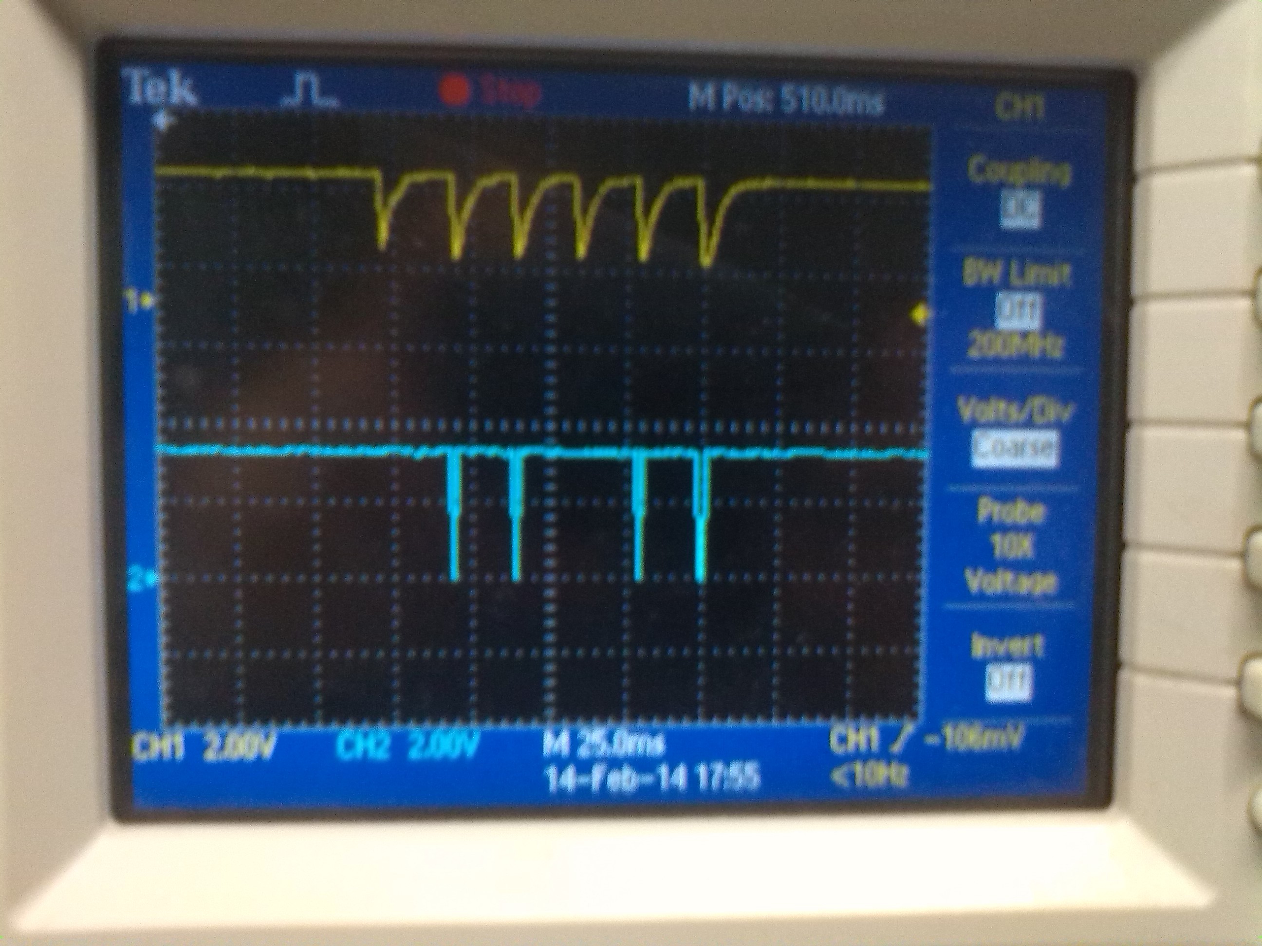

    I have already configure i2c1_pin_mux like this :
    static struct pinmux_config i2c1_pin_mux[] = {
    {"spi0_d1.i2c1_sda", OMAP_MUX_MODE2 | AM33XX_SLEWCTRL_SLOW |
    AM33XX_PIN_INPUT_PULLUP},
    {"spi0_cs0.i2c1_scl", OMAP_MUX_MODE2 | AM33XX_SLEWCTRL_SLOW |
    {NULL, 0},
    In my baseborad the eeprom chip also has pull-up resistors,and I really don't know what to do,I need you help,thanks a lot
  • What is the I2C bus voltage? What is the value of the pullup resistors? How many devices do you have on the I2C bus and are you sure they are configured to different addresses?
  • The bus voltage is 3V3 and the pullup resistor is 4.7KOhm , i2c1 bus has only one device(eeprom)
  • All this seems OK. What is your AM335X processor revision? Have you checked the I2C waveforms with an oscilloscope? What is the I2C_CLK frequency?
  • I already checked the waveforms, when i execute read or write command , can detect some waves but it's abnormality,and the console will print  information eg:
    omap_i2c omap_i2c.2: timeout waiting for bus ready
    In my kernel code, i set the frequency 100KHz by
    omap_register_i2c_bus(2, 100, am335x_i2c0_boardinfo,
    ARRAY_SIZE(am335x_i2c0_boardinfo));
  • Can you post the waveforms?
  • Also please check that your I2C pinmuxing doesn't get overwritten in the kernel?
  • static struct pinmux_config i2c1_pin_mux[] = {
    {NULL, 0},
    static struct at24_platform_data am335x_baseboard_eeprom_info_i2c1 = {
    .byte_len = (32*1024) / 8,
    .page_size = 32,
    .flags = AT24_FLAG_ADDR16,
    static struct i2c_board_info am335x_i2c1_boardinfo[] = {
    /* Baseboard board EEPROM */
    I2C_BOARD_INFO("24c32", 0x50),
    .platform_data = &am335x_baseboard_eeprom_info_i2c1,
    setup_pin_mux(i2c1_pin_mux);
    omap_register_i2c_bus(2, 100, am335x_i2c1_boardinfo,ARRAY_SIZE(am335x_i2c1_boardinfo));
    This modify all based on board-am335xevm.c
    My eeprom chip is 24LC32A

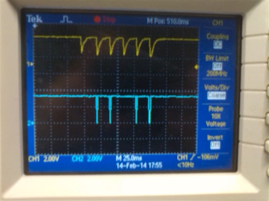

    and the abnormal waveforms as follows:
    it's a little obscure , My phone was too bad.
  • What is the time per division? This looks very very wrong.
  • 25ms. And the yellow one was the clk signal. absolutely wrong,it can't match the frequency that i set in software,but when i execute
    i2cdetect -r 2
    the waveforms detected was as the picture present.
    My question finally solved. I find one i2c signal on my baseboard was connected to a 100K resistor  to ground,so the pullup resistor 4.7K's function was shielded,I think so.I removed the 100K resistor and now the information when i executing i2cdetect -r 2 as follows:
