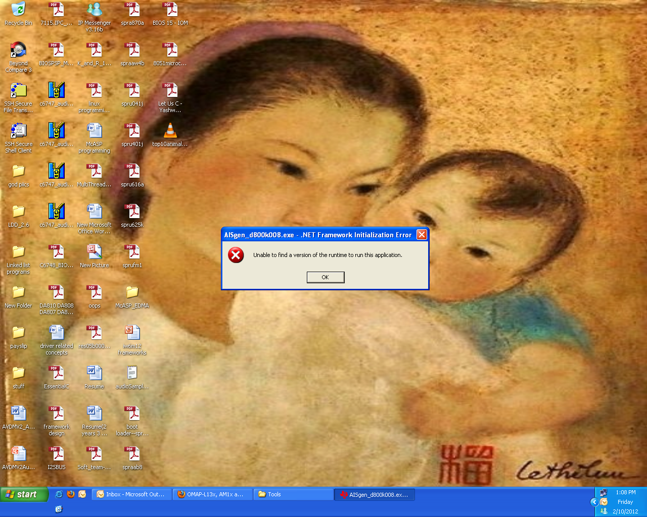

        I have installed Microsoft .NET Framework 4 Setup and also Self-Extracting Cabinet wic_x86_enu, then installed the AISgen_d800k008_Install_v1.9.exe,
but there is an error while running the AISgen tool. Hereby attaching the screen shot.
I am new to this tool,please help me to solve it.

    It looks like AISgen can't find the .NET Framework on your PC.  I have not seen this issue before, but I have a few suggestions:
    1. Reboot your PC to make sure the .NET Framework completed its installation
    2. Try running some other .NET applications (preferably from a third party) to make sure that this is really an AISgen issue and not a PC configuration issue
    3. Try running AISgen in an alternative framework, such as Mono
    Hope this helps.  Please let me know if these ideas still aren't enough to get AISgen running on your PC.
