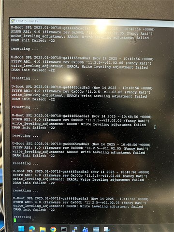

EVM was working fine for 2 weeks. After a power cycle, uBoot failed to initialize memory. COntinuous reboot after that. Request RMA and return. Screenshot 2026-04-29 140307.png

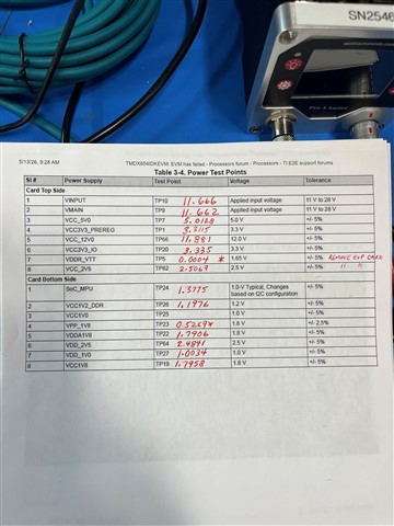

    If the above is not booting could you please measure the voltage on the below Test points and share the results?
    Deepak
  • Hi Deepak
    I put the above image on an SD card and the boot output is shown
    Measured voltages as you requested in RED. I could not find TP25 on this board.
    You can see that the VDDR_VTT and VPP_1V8 are out of spec.

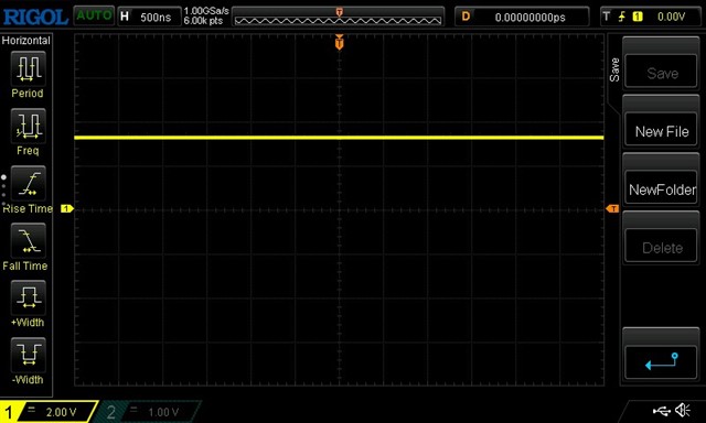

  • Hi Kent,
    Could you please check with on Oscilloscope below location? also check the resistance across the R707 and share it here?
    1. Probe on R707,
    2. Probe on RESETSTATz TP48, MCU_RESETSTATZ TP38, PORz_OUT TP86, MCU_PORz_OUT TP85
    Also one question? all these measurement are taken without bootable media rt?
    Deepak

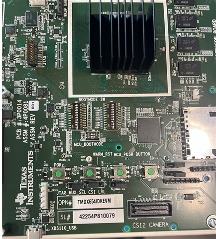

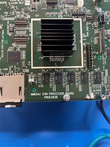

    Could you please share the board details like serial number and Board Revision,? If possible could you please share the image of the board that you are using?
    Also could you please try booting with below image?
    https://dr-download.ti.com/software-development/software-development-kit-sdk/MD-diW9VClvQJ/09.03.05.02/tisdk-default-image-am65xx-evm-09.03.05.02.wic.xz
    Deepak
  • Hi Deepak,
    Images with numbers attached:
    The boot console is the same using the prescribed image.
    Can we get some resolution to this issue?
    Regards, Kent

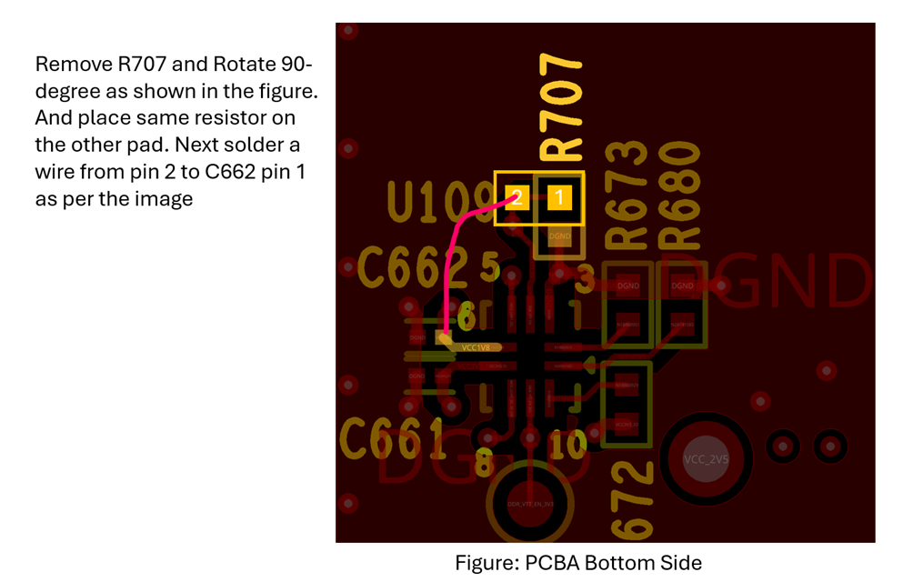

    Could you please check voltage across R707 without SD card and see its 0v? above you mention that 0.687V is with SD card
    If its showing 0v without SD card then we can try providing a 10K pull up to VCC1V8 on DDR_VTT_EN net and remove R707 pull down. See below Instruction
    Deepak
  • Hi Deepak,
    Confirmed voltage around R707 is 0V with SD card removed.
    -Kent
  • Hi Kent,
    Thanks for the confirmation, Would you be able to perform above modification?
    Deepak

    If you can try the previously recommended modification, that is the best approach I can suggest. If that modification does not work, I can suggest another modification to forcefully turn on the VTT Regulator (U10). For that, we would just need to short TP84 to VCC3V3_PREREG (C25.1)

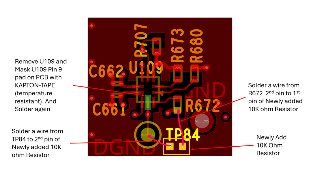

  • Hello Deepak,
    Well, I guess I am forced to attempt repair on this board. The issue is at TP84 (DDR_VTT_EN_3V3). This voltage is at 0V. This enable appears to drive the VTT enable for the DDR4. In looking at the schematic, I cannot find a driving source other than a 100K pull down at R41. Before I tie that pin to VCC3V3_PREREG, please confirm my assumption that this pin should noy be floating.
    Regards, Kent
  • Hi Kent,
    The SoC is attempting to enable the VTT rail through DDR_VTT_EN_3V3 signal, but the signal is failing to reach the required 1.8V threshold (currently measuring 0.678V across R707). To resolve this loading issue and restore functionality without losing other features, isolate the signal by completing the following rework steps:
    • Remove R41 to isolate the signal line.
    • Remove and replace U109 (the level translator) following standard board rework instructions.
    • Install a new 10 kΩ resistor to pull up the VTT enable signal.
    Thank you for attempting the requested rework. Please ensure your workspace is an ESD-safe environment and the soldering station is properly set up before beginning
    Deepak
  • Hi Deepak,
    Would it be as effective to just cut the trace at Pin 9 of U109 to the via connecting to TP84?
    Regards, Kent
  • Hi Kent,
    Yes, If you are capable of cutting the trace without affecting adjacent layer would be okay.
    Deepak

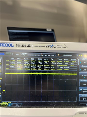

  • Now VDDR_VTT is at a constant output of ~600mV after a power cycle.
    TP5 to DGND is 15.9Kohms at power off.
    Same console output as before. Attached console output and scope trace at TP58.

    DDRSS_DDRPHY_DX0RSR3 = 0x00000000
    CortexA53_0_0: GEL Output:
    DDRSS_DDRPHY_DX1RSR3 = 0x00000000
    DDRSS_DDRPHY_DX2RSR3 = 0x00000001
    DDRSS_DDRPHY_DX3RSR3 = 0x00000000
    DDRSS_DDRPHY_DX4RSR3 = 0x00000000
    DDR4 Initialization has FAILED!!!!
    DDR is configured for 800MHz operation
    CortexA53_0_0: GEL Output: DDRSS_DDRPHY_PGSR0 = 0x808000FF
    Regards, Kent
  • Hi Kent,
    Thanks for sharing the result.
    As per the result, the byte 2 datalines are showing errors. If you want to continue working with the same EVM with reduced DDR data bus, we can try reducing the DDR databus width from 32-bit to 16-bit. I can provide you with a gel file to test with the 16-bit bus width if needed.
    Alternatively, we could try replacing one of the DDR chips, though it is uncertain if the processor side is damaged, similar to the VTT enable pin.
    Deepak
  • Hi Deepak,
    At this point, it makes more sense to get another board. Between the 2 of us, we have been spending many man hours and don't have a positive outcome. For these fine pitched devices, I would have to send the board out to our CM to perform the work.
    Regards, Kent
  • Hi Kent,
    I completely understand your concern, Thank you for your time and efforts in investigating this issue. Please feel free to reach out if you have any further questions or need additional assistance.
    Deepak
