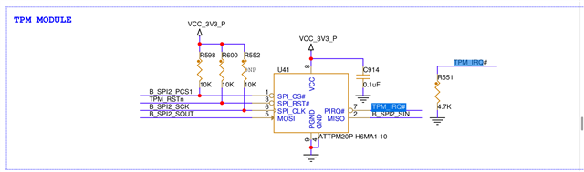

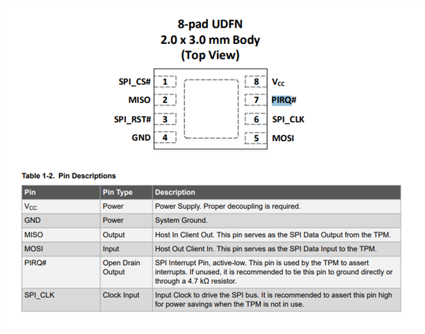

Dear Team,
We have connected SRAM (23A512-I/SN) and TPM (ATTPM20P-H6MA1-10) to the MCU SPI1 interface as slave devices on the DRA821U platform and added the corresponding DTSI entries for both devices. In our configuration, SRAM is connected to CS0 and TPM is connected to CS3.
During boot, we observe a timeout error from the TPM driver:
tpm_tis_spi: probe of spi0.3 failed with error -110.
To debug this, we probed the chip select (CS) pin of the SPI controller. We noticed that when the TPM driver is loading, the CS pin does not toggle low. Throughout the entire boot sequence—from U-Boot to kernel—the CS line remains high (as observed on CRO) but the SRAM CS pin is going to low when the SRAM's driver is loading. Also, the clock is generating properly (12.5 MHz).
Additionally, we are facing an issue with the SRAM device where write operations to the memory block are not functioning as expected.
Could you please guide us on how to resolve these issues? Also, is there any limitation or special consideration for using multiple chip select lines on MCU SPI?

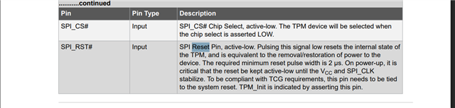

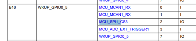

TPM Module SPI_B_CS1#(GPIO_A_7) MCU_MCAN1_RX/MCU_SPI1_CS3/MCU_ADC_EXT_TRIGGER1/WKUP_GPIO0_5 B16 GPIO0_5 Output
TPM_RSTn(GPIO_A_5) SPI0_CS0/UART0_CTSN/GPIO0_51 W3 GPIO0_51 Output
SPI_B_SCK MCU_SPI1_CLK/WKUP_GPIO0_0 B18 GPIO0_0 Output
SPI_B_SDO MCU_SPI1_D0/WKUP_GPIO0_1 B19 GPIO0_1 Output
SPI_B_SDI MCU_SPI1_D1/WKUP_GPIO0_2 D14 GPIO0_2 Input

        J721E_WKUP_IOPAD(0x06c, PIN_OUTPUT, 0) /* (B16) WKUP_GPIO0_5 TPM CS*/

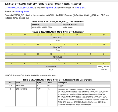

  • Hi Subashini,
    Please reference FAQ:  [FAQ] Troubleshoot Guide for McSPI within Linux: J784S4/AM6x/TDA4x/DRA8x
    May be issue with the internal connection for mcu_spi1
    Takuma
  • Hi Takuma,
    As per the reference you shared, I have added the below DTSi entry for disconnecting the MCU_SPI1 and MCU_SPI3 interconnection in k3-j7200-mcu-wakeup.dtsi file but when checking the register value in the kernel, it shows 0 only. Did I miss anything? Could you please help us to fix this?
     spi1_linkdis: mux-controller@4060 {
     compatible = "reg-mux";
     reg = <0x4060 0x4>;
     #mux-control-cells = <1>;
     mux-reg-masks = <0x0 0x1>;
     idle-states = <1>;
    Thanks and Regards,
    Subashini

  • Hi Subashini,
    That should work. Is the spi1_linkdis node defined under mcu_conf node?
    Takuma

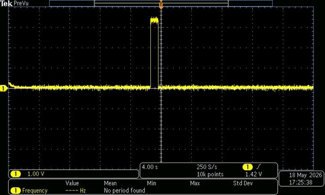

  • Hi Takuma,
    I have added spi1_linkdis under mcu_conf, and now the register value has changed to 0x01. As per your previous reference, I updated J721E_WKUP_IOPAD(0x64, PIN_OUTPUT, 0) to J721E_WKUP_IOPAD(0x64, PIN_OUTPUT, 2)
    After this change, while loading the driver, the chip select line transitions from low to high instead of high to low. I have not changed the SPI controller mode, and it is still operating in Mode 0.
    Additionally, the TPM is throwing a timeout error.
    Could you please guide us on how to resolve this issue?
    Chip select probe image
    Thanks and Regards,
    Subashini
    Instead of 0x64, it should be 0x6C for the TPM CS, that should have the muxing for 2. The 0x64 for CS0 is fine to leave at 0.
    I would recommend using the sysconfig tool for pinmuxing, or reviewing the datasheet.
    Takuma
  • Hi Takuma,
    I am using the below DTSi entry only, and still the chip select line is going low to high.
    &wkup_pmx2 {
    spi_pins_default: spi-pins-default {
    pinctrl-single,pins = <
    J721E_WKUP_IOPAD(0x58, PIN_INPUT, 0) /* (B18) WKUP_GPIO0_0.MCU_SPI1_CLK */
    J721E_WKUP_IOPAD(0x5c, PIN_OUTPUT, 0) /* (B19) WKUP_GPIO0_1.MCU_SPI1_D0 */
    J721E_WKUP_IOPAD(0x60, PIN_INPUT, 0) /* (D14) WKUP_GPIO0_2.MCU_SPI1_D1 */
    J721E_WKUP_IOPAD(0x06c, PIN_OUTPUT, 2) /* (B16) WKUP_GPIO0_5.MCU_SPI1_CS3 */
    &main_pmx0 {
    tpm_reset_pins_default: tpm_reset-default-pins {
    J721E_IOPAD(0x0c0, PIN_OUTPUT, 7) /* (W3) SPI0_CS0.GPIO0_51 */
    &main_gpio0 {
    status = "okay";
    pinctrl-names = "default";
    pinctrl-0 = <&tpm_reset_pins_default>;
    &mcu_spi1 {
    status = "okay";
    pinctrl-0 = <&spi_pins_default>;
    ti,spi-num-cs = <4>;
    ti,pindir-d0-out-d1-in;
    tpm@3 {
    compatible = "tcg,tpm_tis-spi";
    reg = <3>;
    spi-max-frequency = <16000000>;
    reset-gpios = <&main_gpio0 51 GPIO_ACTIVE_HIGH>;
    status = "okay";
    Thanks and Regards,
    Subashini

    I see in TPM datasheet that the reset signal is active low instead of active high:
    Takuma
  • Hi Takuma,
    I have tried configuring reset-gpios = <&main_gpio0 51 GPIO_ACTIVE_LOW>; However, the chip select line is still toggling from low to high.
    Could you please let me know if there are any limitations with MCU SPI1? We observed that CS0 is working properly, but CS3 appears to have a chip select polarity inversion issue.
    Also, could you confirm whether MCU SPI1 supports multiple slave devices connected across different chip select lines?
    Thanks and Regards,
    Subashini
  • Hi Takuma,
    I probed the TPM reset pin and observed that it stays low throughout the entire boot process. However, the expected behavior is that the reset line should remain high when the board powers on, and during TPM driver loading it should toggle from high to low.
    To address this, I configured the TPM reset GPIO as high using the gpio-hog property in the DTSI. After this change, the reset line goes high during TPM driver loading, but it remains high continuously and does not toggle as expected.
    I also tried changing the GPIO value through the kernel sysfs interface and probed the signal using the CRO. On the CRO, the GPIO value is toggling correctly, but in the kernel it still shows the value as 0.
    Is there any workaround or recommended approach to make the GPIO toggle properly during runtime?
    Thanks and Regards,
    Subashini

    J721E_WKUP_IOPAD(0x06c, PIN_OUTPUT, 2) /* (B16) WKUP_GPIO0_5 TPM CS*/

    Does the TPM device have a physical interrupt pin that is connected on your system?
    Takuma
  • Hi Takuma,
    TPM doesn't have an interrupt; only the MCU SPI1 has an interrupt as shown below.

  • Hi Subashini,
    I recommend reading the datasheet of the device. The TPM datasheet looks to have an extra IRQ pin that is not present for the SRAM that you are using:
    Since the SRAM is working, I suspect the issue is specific to TPM, so please review the TPM datasheet and software to see if there is anything that stands out.
    Takuma
  • Hi Takuma,
    As per the TPM device's datasheet, we are not using the interrupt pin; also, it is connected to a 4.7K-ohm resistor.
    Thanks and Regards,
    Subashini.
