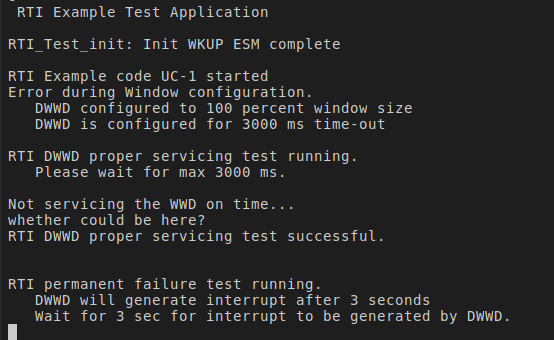

I want to use use Windowed Watchdog Timer to generate reset via not servicing the watchdog on time. The example I am using is "rti_app_uc1" from "mcu_plus_sdk_am62px_11_01_01_08/examples/sdl/rti/UC1". I have configured the WWD reaction to GENERATE_RESET via modifying the code as follows.
/* Configure RTI parameters */
    pConfig.SDL_RTI_dwwdPreloadVal = RTIGetPreloadValue(RTI_CLOCK_SOURCE_32KHZ, RTI_WDT_TIMEOUT);
    pConfig.SDL_RTI_dwwdWindowSize = RTI_DWWD_WINDOWSIZE_100_PERCENT;
    pConfig.SDL_RTI_dwwdReaction   = RTI_DWWD_REACTION_GENERATE_RESET;
The time interval I configured for WWD is 3s. After I start the WWD, I implement a 4s delay to generate a WWD timeout. But I find the timeout dose not trigger the MCU reset and the code could continue run.
I attach the related code and logs below.

  • The ESM init config I used is attached above. I am trying to enable MCU_RTI0_INTR for WKUP_ESM0. The MCU+SDK I am using is 11.01.01.08. I wonder whether my ESM configuration is correct or not?
    BR,
    Bomiao
  • Hello Bomiao,
    Please follow the FAQ below to configure the structure parameters. You need to configure only the enable bitmap and priority bitmap fields.
    Enable only the 85th interrupt to route the MCU RTI interrupt to WKUP ESM. All other bits should be configured to zero.
    Please let me know if you face any issues

  • Hi Swargam,
    After adjusting the ESM interrupt enable map, now I could generate RESET. However I found that whatever pConfig.SDL_RTI_dwwdReaction is set as RTI_RTIDWWDRXNCTRL_DWWDRXN_INTERRUPT or RTI_RTIDWWDRXNCTRL_DWWDRXN_RESET, the WWDG timeout always triggers Main domain RESET. Is this phenomenon correct? I thought the Main domain RESET will only be generated with
    pConfig.SDL_RTI_dwwdReaction   = RTI_DWWD_REACTION_GENERATE_RESET.
    Bomiao
  • Hello Bomiao,
    In the FAQ above , there is a CTRL MMR register that determines whether the SOC receives a reset after the WDT expires.
    If this bit is set, regardless of the pConfig.SDL_RTI_dwwdReaction setting (RTI_DWWD_REACTION_GENERATE_RESET or
    RTI_DWWD_REACTION_GENERATE_INTERRUPT), the SOC will always reset.
    Anil
