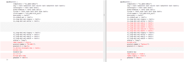

  • I see some differences in the SD node between the DTS extracted from your shared U-Boot image and the DTS extracted from the U-Boot image from SDK v11.02.
    I would like you to use the DTS files from whichever SDK version you have ported to as it is and apply the changes on top of it. You should not be using the DTS files as it is from the previous SDK version to the SDK version you have ported to.
  • The changes made are due to the following: 1) I have a single 3.3V power supply, so it doesn't switch to 1.8V. 2) The name to identify it. 3) SDR and DDR were what you recommended in a previous answer. 4) The control pin is the same; yesterday I changed the CLK pin in this SDK version to input in the pin configuration.
    You shouldn't need any other changes than deleting the OTAP values as suggested in the other thread. There are other differences like the "bootph-pre-ram" in your DTS and "bootph-all" in the default DTS.
    I would like to minimize the differences in the DTS for us to proceed further.
    Is it the case that you are using the DTS as is from the previous U-Boot version to the new U-Boot version. If so, this may likely cause issues. It is expected that you use the default DTS and port the changes from the previous base to the new base.

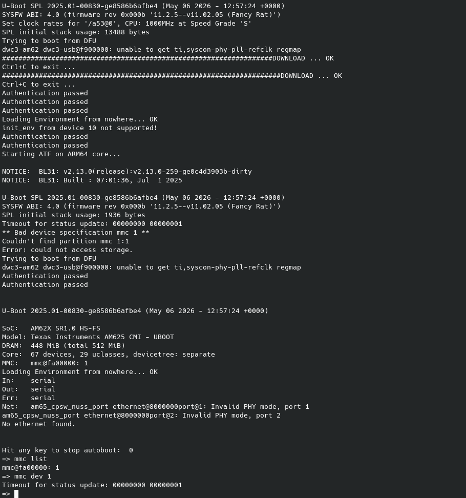

  • I upgraded to uboot 2025.04, and the configuration I had in uboot 2023.04 isn't working
    I understood this as you have a working baseline with U-Boot 2023.04 and now migrating to U-Boot 2025.04 where you see the issue with the SD card. Isn't this the case?
  • Of course, in the previous version 2023.04 everything worked without problems, the initial boot and booting from SD.
    After migrating to the new version and making the changes according to 2025.04, it won't boot from the SD card. If I boot from USB DFU, I reach the uboot prompt and the SD card is listed as dev 1; I can even boot the kernel from there. But it just doesn't work, and that's why I was wondering if that error was related to something in the SPL.
  • If I boot from USB DFU, I reach the uboot prompt and the SD card is listed as dev 1; I can even boot the kernel from there.

  • boot from usb-dfu:
    U-Boot SPL 2025.01-00847-gf8cc38c9444e (May 08 2026 - 12:15:45 +0000)
    SYSFW ABI: 4.0 (firmware rev 0x000b '11.2.5--v11.02.05 (Fancy Rat)')
    Set clock rates for '/a53@0', CPU: 1000MHz at Speed Grade 'S'
    SPL initial stack usage: 13424 bytes
    Trying to boot from DFU
    ##################################################################DOWNLOAD ... OK
    Ctrl+C to exit ...
    ####################################################################DOWNLOAD ... OK
    Ctrl+C to exit ...
    Authentication passed
    Loading Environment from nowhere... OK
    init_env from device 10 not supported!
    Starting ATF on ARM64 core...
    NOTICE:  BL31: v2.13.0(release):v2.13.0-259-ge0c4d3903b-dirty
    NOTICE:  BL31: Built : 07:01:36, Jul  1 2025
    SPL initial stack usage: 1936 bytes
    MMC: no card present
    ** Bad device specification mmc 1 **
    Couldn't find partition mmc 1:1
    Error: could not access storage.
    U-Boot 2025.01-00847-gf8cc38c9444e (May 08 2026 - 12:15:45 +0000)
    SoC:   AM62X SR1.0 HS-FS
    Model: Texas Instruments AM625 CMI - UBOOT
    DRAM:  448 MiB (total 512 MiB)
    Core:  67 devices, 29 uclasses, devicetree: separate
    MMC:   mmc@fa00000: 1
    In:    serial
    Out:   serial
    Err:   serial
    Net:   am65_cpsw_nuss_port ethernet@8000000port@1: Invalid PHY mode, port 1
    am65_cpsw_nuss_port ethernet@8000000port@2: Invalid PHY mode, port 2
    No ethernet found.
    Hit any key to stop autoboot:  0

    You are not running any "mmc dev 1" command in these DFU boot logs. In the first response of yours, the attached response shows that you are booting U-Boot over USB DFU and running the mmc commands in the A53 U-Boot which runs into issues.
    boot from SD (MMC1):
    I would think this may not be caused by the SD card as the R5 SPL logs would at least have "Trying to boot from MMC2" before trying to initialize the SD card and reading the image from it.

    Here are some more detailed logs:
    from usb-dfu:
    U-Boot SPL 2025.01-00885-g2e31d90794e1 (May 11 2026 - 15:50:09 +0000)
    CMD_SEND:0
                   ARG                      0x00000000
    Timeout for status update: 00000000 00000001
                   RET                      -110

    U-Boot 2025.01-00885-g2e31d90794e1 (May 11 2026 - 15:50:09 +0000)
    MMC:   mmc@fa00000: 1
    In:    serial
    Out:   serial
    Err:   serial
    No ethernet found.
    => mmc dev 1

    Is this image built with the additional DFU fragment? If so, please note the U-Boot binaries must be built separately for DFU and other boot media like SD card.
  • Is this image built with the additional DFU fragment? If so, please note the U-Boot binaries must be built separately for DFU and other boot media like SD card.
    The problem was that I had the setting to boot via DFU enabled on R5. When I removed it, it booted without any issues, and this path also worked because the voltage was set to 3.3V. I thought that if the #include <configs/am62x_r5_usbdfu.config> wasn't included when entering DFU mode, it would be ignored.
    &sdhci1 {
    /* SD/MMC */
    vmmc-supply = <&vdd_mmc1>;
    // vqmmc-supply = <&vdd_sd_dv>;
    /delete-property/ ti,otap-del-sel-sdr12;
    /delete-property/ ti,otap-del-sel-sdr25;
    /delete-property/ ti,otap-del-sel-sdr50;
    /delete-property/ ti,otap-del-sel-ddr50;
    /delete-property/ ti,otap-del-sel-sdr104;
    pinctrl-names = "default";
    pinctrl-0 = <&main_mmc1_pins_default>;
    ti,driver-strength-ohm = <50>;
    bus-width = <4>;
    broken-cd;
    disable-wp;
    no-1-8-v;
    status = "okay";
