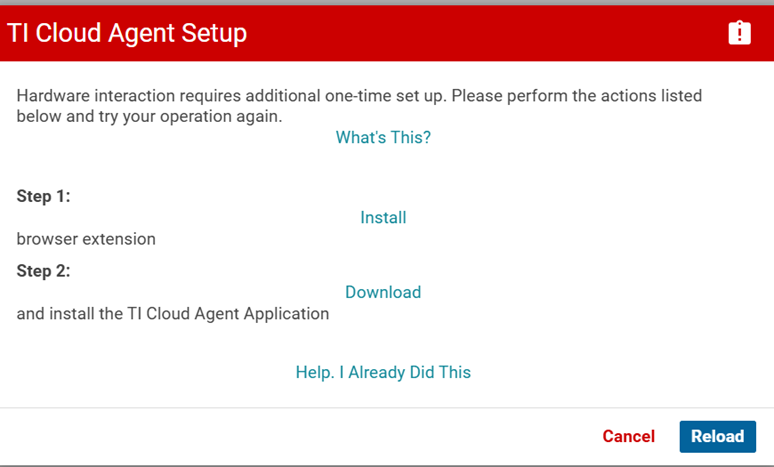

I'm trying to use edge-ai-studio-MCU with TimeSeries solution.
When I create new project, I saw following message.
Follow this message, I installed "TI cloud agent bridge" to "Microsoft edge" and "TI cloud agent application" in my windows 11 PC.

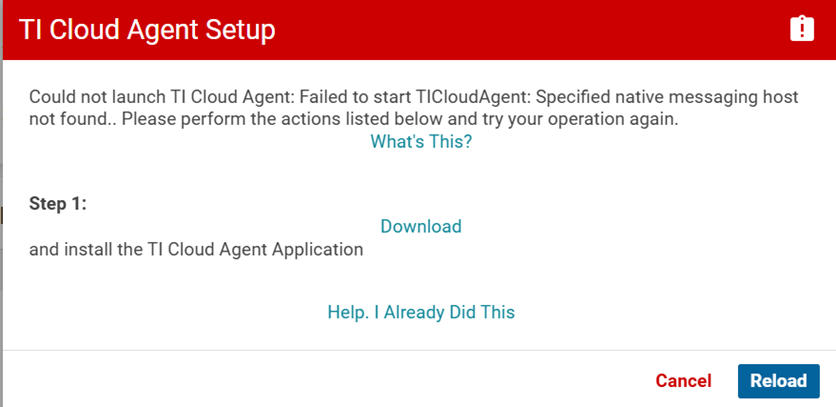

After that, when I performed "Reload", I saw still following message.
When I install "TI cloud agent application" in my windows11 PC, I did not see any error.
Could you please tell me how I can avoid this error ?
    Are you using the desktop or cloud (online version)? If the latter, can you try a different browser like Chrome?
    ki
    I'm using cloud version.
    Previously, I use "Microsoft edge" as browser. However, as you said, when I change different browser(change to "Google Chrome"), since there is no pop up message which I posted, so it seems that I can use this environment.
    If I observe another problem, I will let you know.
