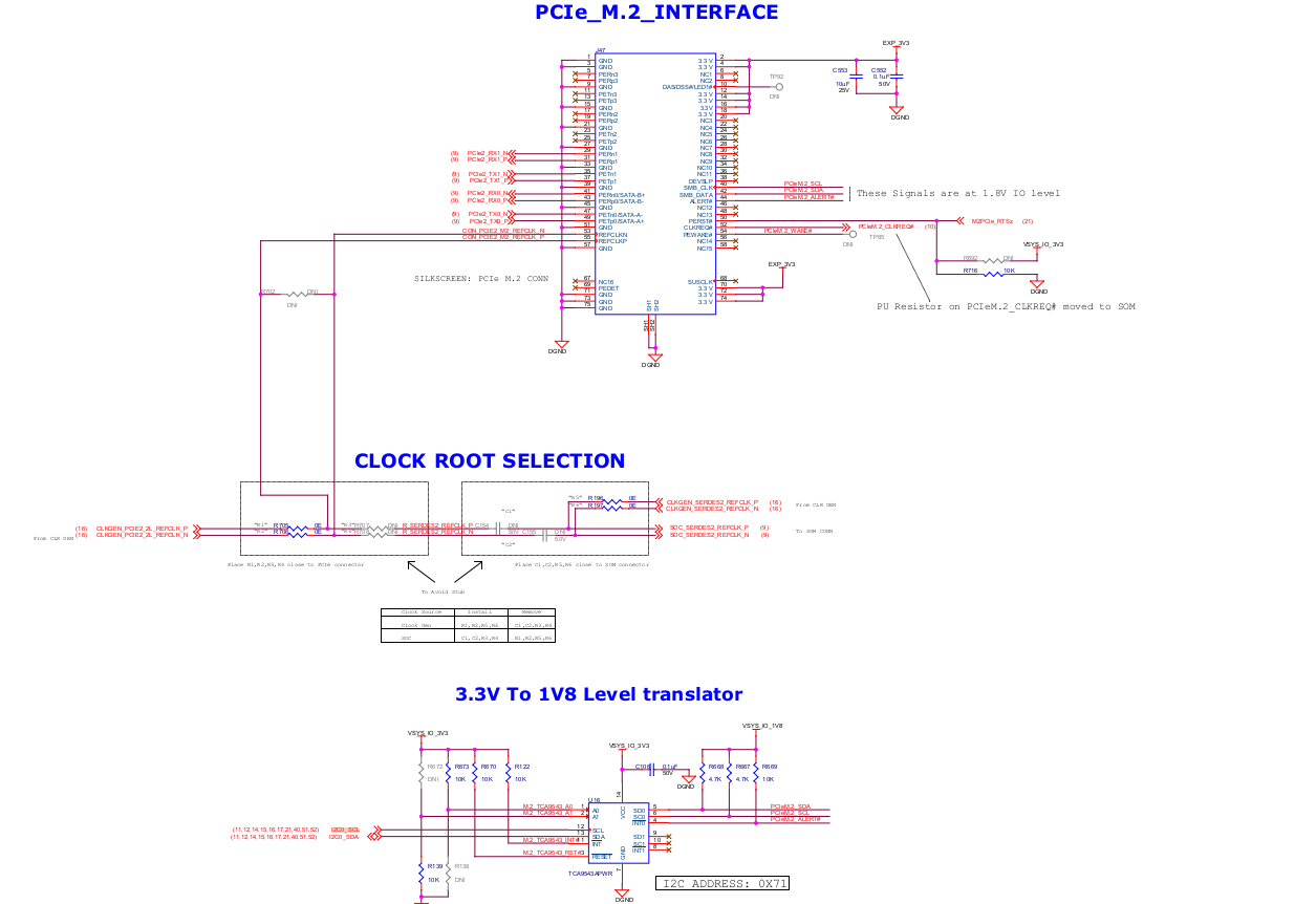

Im new to the PCIE and we are working for the custom board in that we are using PCIE M.2 where will the PCIE work if i remove the TCA9543APWR SMB bus.
We are using TDA4VM EVM for reference.

    Yes, PCIe will work on your custom board without the TCA9543APWR — but there are a couple of things to be aware of.
    Background: the EVM has two TCA9543APWRs
    The TDA4VM EVM uses two of these devices on SoC_I2C0:
    | I2C Address | Function |
    | 0x70             | SMBus MUX for the x1-lane and x2-lane PCIe card connectors |
    | 0x71             | SMBus MUX / level translator for the M.2 PCIe connector (SERDES2) |
    The one connected to the M.2 slot (0x71) is a voltage level translator for the M.2 SMBus signals — per the EVM User Guide, it "changes the I/O level of SMBUS signals to 1.8V." It has no involvement in PCIe link training, lane initialization, or data transfer.
    PCIe operates entirely over the differential TX/RX data lanes and the reference clock — the SMBus lines on the M.2 connector are sideband signals that carry no PCIe traffic.
    What you lose without the M.2 TCA9543APWR (0x71):
    - The SMBus path to the M.2 device. SMBus is sometimes used by M.2 modules for out-of-band management functions such as temperature reporting or firmware update, but this is device-specific. Whether your M.2 device requires SMBus depends on what module you are using (see questions below).
    What is unaffected:
    - PCIe link training and LTSSM operation
    - PCIe enumeration and BAR configuration
    - PCIe data transfer
    If your custom board also has PCIe card connectors (x1 or x2 lane slots): the 0x70 mux serves those connectors and is a separate device. Removing it would similarly have no effect on PCIe operation but would remove the SMBus path to those slots.

    Thankyou for your response, Here we are planning to use NVMe SSD in the PCIE M.2 line and we are using the TI SDK/PDK for TDA4VM.

    Great — with NVMe SSD and the TI SDK/PDK, the situation becomes clearer.
    Regarding PCIe functionality:
    In typical implementations, NVMe SSDs communicate over PCIe lanes and do not require SMBus for basic operation. However, to be completely certain, you should verify with your specific NVMe SSD vendor documentation — confirm that SMBus is not required for initialization or firmware operations on your particular drive. Assuming your drive does not require SMBus, you can safely remove the TCA9543APWR (0x71) from your custom board. If SMBus is needed, it would typically be for optional out-of-band features (like temperature monitoring).
