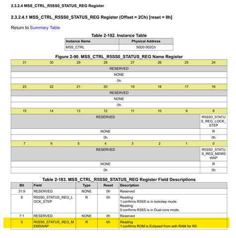

  • Hi Yugendra,
    When the ROM loads SBL successfully, it eclipses itself on R5 core, so that the SBL could run. During this process, the below register is set to confirm the eclipse.
  • Thanks Nikhil Dasan this is one part of the information that i was looking for as part of this ticket.
    Can you also help me with the register information to look for when the HSM ROM gets eclipsed.
  • Hi
    HSM ROM would only be eclipsed if you load the HSMRT.
    So the SBL is responsible for loading the HSMRT. Hence once the SBL is up, you can using the API Bootloader_socLoadHsmRtFw() to load the HSMRT.
    This is a blocking API and successful execution of the same in SBL says that the HSM ROM is eclipsed.
