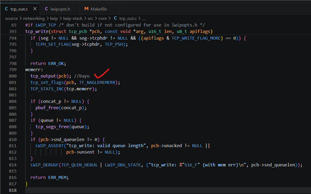

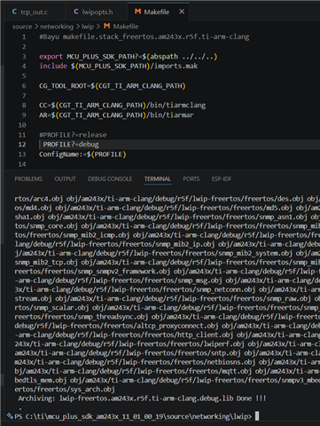

I already tried the suggested workaround by adding:
#define TCP_TMR_INTERVAL 10
to the lwipopts.h file in the lwIP library:
C:\ti\mcu_plus_sdk_am243x_11_01_00_19\source\networking\lwip
Then I recompiled the library successfully and included it in the Industrial Communications Modbus TCP Server example.
However, when I tested it, the result was still the same.

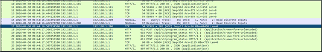

I tested several Modbus functions such as:
  • Read Discrete Inputs (FC 2)
  • Write Multiple Coils (FC 15)
I used several Modbus TCP client applications on my computer and monitored the traffic using Wireshark. I calculated the time difference between the request and response packets.
The response times are:
  • FC 2: around 1 ms
  • FC 15: around 14 ms
However, the strange thing is that the data values are not updated simultaneously. The data only gets updated after around 200 ms.
