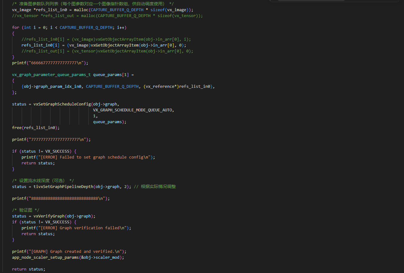

Hello

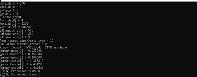

I have a question. I want to add a post-processing node for TIDL, but no matter whether I add it to the A core or the C7X core, the app freezes when running the vxverigraph function without any error. The node I added only has two parameters, with types of vx_user_data_object and vx_tensor. Based on your experience, could you please tell me what might be causing this issue

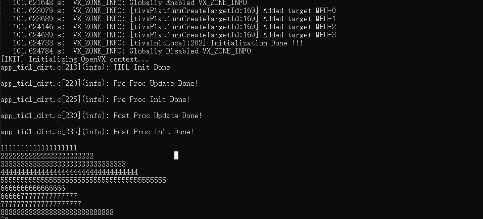

  • Hi
    How can I enable remote core logging?

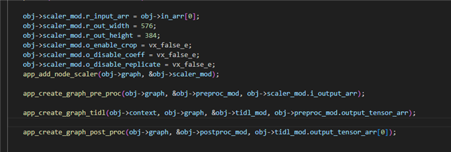

    I developed this app myself. First, an offline YUV image with a resolution of 1920x1536 is loaded. Then, it is cropped using a scaler node to a resolution of 576x384. After preprocessing, the NV12 format image is converted to RGB Tensor format and fed to the TIDL node. Finally, it is sent to the post-processing node I created. The issue of freezing has been resolved, but a new problem has arisen. The post-processing node I created runs successfully on core A, but if it runs on C7X, it freezes after two frames. How can I troubleshoot this issue?
    "source /opt/vision_apps/vision_apps_init.sh"

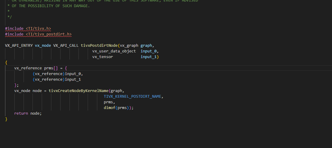

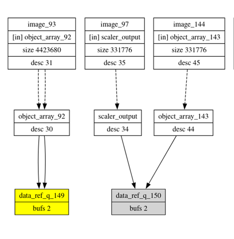

    check the remote core logs if there is any error in c7x.
    Also could you share the graph's dot output file that will be generated by tivxExportGraphToDot() api, add this api in your code and share the files that it generates,
    https://software-dl.ti.com/jacinto7/esd/processor-sdk-rtos-jacinto7/latest/exports/docs/tiovx/docs/user_guide/JPEG_TOOL.html

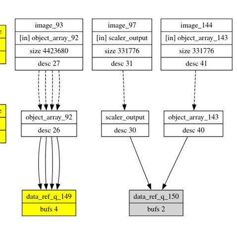

  • Hello
    There is no script named "vision_apps_init.sh" in this directory (/opt/vision_apps/). How can I generate this script? Or can you provide it?
    Below is the file generated by executing this function. Please check it

  • Hi Zhang,
    It should be in the sdk's targetfs file, can you check inside the sdk and copy the entire vision_apps folder to your board. $(psdkra)/targetfs/opt/vision_apps
    this also will have few binaries. FYI, this will work if there is no change in memory map, If you have changed the memory then you might have to recompile those binaries.
    From the graph's dot output it seems like the graph is not created properly.
    data_ref_q_149 is pointing to one buffer but the information says it has 4 buffers. Can you check the app_tidl_od demo as reference, vision_apps/apps/dl_demos/app_tidl_od
    Could you check your graph creation part of your msc node and compare it with the app_tidl_od demo code.
    Gokul
  • Hello
    1. Our software colleagues have modified the compilation method of our SDK, and there is no targetfs file in the SDK anymore. Therefore, we cannot find "vision_apps_init.sh". Is there any way to obtain it
    2. I made modifications based on the demo you provided, but the app still freezes after two frames. Please take a look at the result of running the app after the modifications.

            <TR><TD bgcolor="antiquewhite">VPAC_MSC1</TD></TR>
            <TR><TD bgcolor="lightblue">MPU-0</TD></TR>
            <TR><TD bgcolor="yellow">DSP_C7-1</TD></TR>
            </TABLE>>];
    /* List of nodes ( Pipeline = 0 )*/
    n_36 [shape=record, label="{ScalerNode|pipe 0|desc 36}", style=filled, fillcolor=antiquewhite]
    n_37 [shape=record, label="{PreProcNode|pipe 0|desc 37}", style=filled, fillcolor=lightblue]
    n_38 [shape=record, label="{tidl_node|pipe 0|desc 38}", style=filled, fillcolor=yellow]
    n_39 [shape=record, label="{post_proc_node|pipe 0|desc 39}", style=filled, fillcolor=yellow]
    /* List of nodes ( Pipeline = 1 )*/
    n_40 [shape=record, label="{ScalerNode|pipe 1|desc 40}", style=filled, fillcolor=antiquewhite]
    n_41 [shape=record, label="{PreProcNode|pipe 1|desc 41}", style=filled, fillcolor=lightblue]
    n_42 [shape=record, label="{tidl_node|pipe 1|desc 42}", style=filled, fillcolor=yellow]
    n_43 [shape=record, label="{post_proc_node|pipe 1|desc 43}", style=filled, fillcolor=yellow]
    /* Dependency of nodes within pipeline (Pipeline = 0) */
    n_36 -> n_37 [style=dashed]
    n_36 -> n_37 [style=dashed, color=gray]
    n_37 -> n_38 [style=dashed]
    n_37 -> n_38 [style=dashed, color=gray]
    n_38 -> n_39 [style=dashed]
    n_38 -> n_39 [style=dashed, color=gray]
    /* Dependency of nodes within pipeline (Pipeline = 1) */
    n_40 -> n_41 [style=dashed]
    n_40 -> n_41 [style=dashed, color=gray]
    n_41 -> n_42 [style=dashed]
    n_41 -> n_42 [style=dashed, color=gray]
    n_42 -> n_43 [style=dashed]
    n_42 -> n_43 [style=dashed, color=gray]
    ln_36 [shape=record, label="{ScalerNode|pipe 0|desc 36}", style=filled, fillcolor=antiquewhite]
    ln_37 [shape=record, label="{PreProcNode|pipe 0|desc 37}", style=filled, fillcolor=lightblue]
    ln_38 [shape=record, label="{tidl_node|pipe 0|desc 38}", style=filled, fillcolor=yellow]
    ln_39 [shape=record, label="{post_proc_node|pipe 0|desc 39}", style=filled, fillcolor=yellow]
    ln_40 [shape=record, label="{ScalerNode|pipe 1|desc 40}", style=filled, fillcolor=antiquewhite]
    ln_41 [shape=record, label="{PreProcNode|pipe 1|desc 41}", style=filled, fillcolor=lightblue]
    ln_42 [shape=record, label="{tidl_node|pipe 1|desc 42}", style=filled, fillcolor=yellow]
    ln_43 [shape=record, label="{post_proc_node|pipe 1|desc 43}", style=filled, fillcolor=yellow]
    /* Dependency of nodes across pipeline ( Pipeline = 0 ) */
    ln_40 -> ln_36 [style=dashed]
    ln_41 -> ln_37 [style=dashed]
    ln_42 -> ln_38 [style=dashed]
    ln_43 -> ln_39 [style=dashed]
    /* Dependency of nodes across pipeline ( Pipeline = 1 ) */
    ln_36 -> ln_40 [style=dashed]
    ln_37 -> ln_41 [style=dashed]
    ln_38 -> ln_42 [style=dashed]
    ln_39 -> ln_43 [style=dashed]
    /* List of Data References */
    d_31 [shape=record , label="{image_93  | [in] object_array_92 | size 4423680 | desc 31}"]
    d_30 [shape=record , label="{object_array_92    | desc 30}"]
    d_35 [shape=record , label="{image_97  | [in] scaler_output | size 331776 | desc 35}"]
    d_34 [shape=record , label="{scaler_output    | desc 34}"]
    d_27 [shape=record , label="{user_data_object_87   | size 52 | desc 27}"]
    d_26 [shape=record , label="{tensor_89  | [in] object_array_88 | size 2654208 | desc 26}"]
    d_25 [shape=record , label="{object_array_88    | desc 25}"]
    d_12 [shape=record , label="{tidl_node_config   | size 189348 | desc 12}"]
    d_13 [shape=record , label="{tidl_node_network   | size 5987880 | desc 13}"]
    d_14 [shape=record , label="{tidl_node_createParams   | size 672 | desc 14}"]
    d_17 [shape=record , label="{user_data_object_82  | [in] tidl_node_in_args_arr | size 112 | desc 17}"]
    d_16 [shape=record , label="{tidl_node_in_args_arr    | desc 16}"]
    d_20 [shape=record , label="{user_data_object_84  | [in] tidl_node_out_args_arr | size 233808 | desc 20}"]
    d_19 [shape=record , label="{tidl_node_out_args_arr    | desc 19}"]
    d_23 [shape=record , label="{tensor_86  | [in] tidl_node_output_tensor_arr | size 8 | desc 23}"]
    d_22 [shape=record , label="{tidl_node_output_tensor_arr    | desc 22}"]
    d_28 [shape=record , label="{user_data_object_90   | size 8 | desc 28}"]
    d_data_ref_q_149 [shape=record, style=filled , fillcolor=yellow, label="{data_ref_q_149|bufs 2}"]
    d_30 -> d_data_ref_q_149
    d_31 -> d_30 [style=dashed]
    d_data_ref_q_150 [shape=record, style=filled , fillcolor=lightgrey, label="{data_ref_q_150|bufs 2}"]
    d_34 -> d_data_ref_q_150
    d_35 -> d_34 [style=dashed]
    d_44 [shape=record , label="{object_array_143    | desc 44}"]
    d_44 -> d_data_ref_q_150
    d_45 [shape=record , label="{image_144  | [in] object_array_143 | size 331776 | desc 45}"]
    d_45 -> d_44 [style=dashed]
    d_data_ref_q_151 [shape=record, style=filled , fillcolor=lightgrey, label="{data_ref_q_151|bufs 2}"]
    d_25 -> d_data_ref_q_151
    d_26 -> d_25 [style=dashed]
    d_46 [shape=record , label="{object_array_145    | desc 46}"]
    d_46 -> d_data_ref_q_151
    d_47 [shape=record , label="{tensor_146  | [in] object_array_145 | size 2654208 | desc 47}"]
    d_47 -> d_46 [style=dashed]
    d_data_ref_q_152 [shape=record, style=filled , fillcolor=lightgrey, label="{data_ref_q_152|bufs 2}"]
    d_22 -> d_data_ref_q_152
    d_23 -> d_22 [style=dashed]
    d_48 [shape=record , label="{object_array_147    | desc 48}"]
    d_48 -> d_data_ref_q_152
    d_49 [shape=record , label="{tensor_148  | [in] object_array_147 | size 8 | desc 49}"]
    d_49 -> d_48 [style=dashed]
    /* List of data reference queues */
    d_58 [shape=record, style=filled , fillcolor=yellow, label="{data_ref_q_149|bufs 2|pipe 0|in_nodes 1|desc 58 }"]
    d_60 [shape=record, style=filled , fillcolor=yellow, label="{data_ref_q_149|bufs 2|pipe 1|in_nodes 1|desc 60 }"]
    d_64 [shape=record, style=filled , fillcolor=lightgrey, label="{data_ref_q_150|bufs 2|pipe 0|in_nodes 1|desc 64 }"]
    d_65 [shape=record, style=filled , fillcolor=lightgrey, label="{data_ref_q_150|bufs 2|pipe 1|in_nodes 1|desc 65 }"]
    d_67 [shape=record, style=filled , fillcolor=lightgrey, label="{data_ref_q_151|bufs 2|pipe 0|in_nodes 1|desc 67 }"]
    d_68 [shape=record, style=filled , fillcolor=lightgrey, label="{data_ref_q_151|bufs 2|pipe 1|in_nodes 1|desc 68 }"]
    d_70 [shape=record, style=filled , fillcolor=lightgrey, label="{data_ref_q_152|bufs 2|pipe 0|in_nodes 1|desc 70 }"]
    d_71 [shape=record, style=filled , fillcolor=lightgrey, label="{data_ref_q_152|bufs 2|pipe 1|in_nodes 1|desc 71 }"]
    d_58 -> n_36 [label=" replicated"]
    n_36 -> d_64 [label=" replicated"]
    d_27 -> n_37
    d_64 -> n_37 [label=" replicated"]
    n_37 -> d_67 [label=" replicated"]
    d_12 -> n_38
    d_13 -> n_38
    d_14 -> n_38
    d_17 -> n_38 [label=" replicated"]
    d_20 -> n_38 [label=" replicated"]
    d_67 -> n_38 [label=" replicated"]
    n_38 -> d_70 [label=" replicated"]
    d_28 -> n_39
    d_70 -> n_39 [label=" replicated"]
    d_60 -> n_40 [label=" replicated"]
    n_40 -> d_65 [label=" replicated"]
    d_27 -> n_41
    d_65 -> n_41 [label=" replicated"]
    n_41 -> d_68 [label=" replicated"]
    d_12 -> n_42
    d_13 -> n_42
    d_14 -> n_42
    d_17 -> n_42 [label=" replicated"]
    d_20 -> n_42 [label=" replicated"]
    d_68 -> n_42 [label=" replicated"]
    n_42 -> d_71 [label=" replicated"]
    d_28 -> n_43
    d_71 -> n_43 [label=" replicated"]
    digraph final_graph.dot {
    dq_cmd_59 [shape=record, label="{response cmd|desc 58}", style=filled]
    d_58 -> dq_cmd_59
    d_58 -> queue_63 [label="release"]
    queue_62 -> d_58 [label="acquire"]
    dq_cmd_61 [shape=record, label="{response cmd|desc 60}", style=filled]
    d_60 -> dq_cmd_61
    d_60 -> queue_63 [label="release"]
    queue_62 -> d_60 [label="acquire"]
    queue_63 -> dequeue_0 [label="done"]
    enqueue_0 -> queue_62 [label="ready"]
    d_64 -> queue_66 [label="release"]
    queue_66 -> d_64 [label="acquire"]
    d_65 -> queue_66 [label="release"]
    queue_66 -> d_65 [label="acquire"]
    d_34 -> queue_66
    d_44 -> queue_66
    d_67 -> queue_69 [label="release"]
    queue_69 -> d_67 [label="acquire"]
    d_68 -> queue_69 [label="release"]
    queue_69 -> d_68 [label="acquire"]
    d_25 -> queue_69
    d_46 -> queue_69
    d_70 -> queue_72 [label="release"]
    queue_72 -> d_70 [label="acquire"]
    d_71 -> queue_72 [label="release"]
    queue_72 -> d_71 [label="acquire"]
    d_22 -> queue_72
    d_48 -> queue_72
      ColorScheme [shape=none, margin=0, label=<
            <TABLE BORDER="0" CELLBORDER="1" CELLSPACING="0" CELLPADDING="4">
            </TABLE>>];
    d_27 -> n_37
    d_12 -> n_38
    d_13 -> n_38
    d_14 -> n_38
    d_28 -> n_39
    Meanwhile, I executed journalctl -b|grep C7x to check the logs of c7x's operation, but it seems that the post-processing node placed in c7x is not visible. Please help analyze the reason
    3. Could the phenomenon of crashing be related to insufficient memory in the c7x
    root@spartan_a:/# journalctl -b|grep C7x
    Dec 31 16:00:05[ 9.150961] spartan vx_app_arm_remote_log.out[279]: [C7x_1 ] 5.217910 s: CIO: Init ... Done !!!
    Dec 31 16:00:05[ 9.151209] spartan vx_app_arm_remote_log.out[279]: [C7x_1 ] 5.218082 s: CPU is running FreeRTOS
    Dec 31 16:00:05[ 9.151458] spartan vx_app_arm_remote_log.out[279]: [C7x_1 ] 5.218250 s: APP: Init ... !!!
    Dec 31 16:00:05[ 9.151716] spartan vx_app_arm_remote_log.out[279]: [C7x_1 ] 5.218401 s: SCICLIENT: Init ... !!!

  • Hi Zhang,
    Ok, anyway you have the output from vx_app_arm_remote_log.out, vision_apps_init.sh script will run this application in background. So this is fine the logs you shared is the remote core logs.
    No, I think you just reduced the num_of buffers and hence it results like this,
    Your data_ref_q_149 should be looking similar to data_ref_q_150 ( like 2 separate image buffers )
    Could you check and correct this.
    The error logs says its Illegal opcode exception and the c7x core has went into exception.
    Dec 31 16:00:50[ 54.533390] spartan_a vx_app_arm_remote_log.out[279]: [C7x_1 ] 61.892720 s: Illegal opcode exception
    Have you validated your kernel in c7x independently without adding into the tiovx pipeline, can you validate independently and fix the error.
    Possible reason for this error could be,
    • Invalid opcodes within a format
    • Greater than 64-bit stores on D1 unit or greater than 64-bit loads on D2 unit
    • Illegal instructions on scalar side and on the vector side
    • Addressing mode is not 3’h0 or 3’h4 for PFS instruction
    • Addressing mode is not 3’h0 or 3’h4 for ASW, ASD, CASW, CASD instructions
    And next time when you share the logs share it as a text file or use the code window.
    Gokul
  • 1.How can I identify the error in this image? Where do I need to modify in the code?
    2.The post-processing node can run on core A, but it freezes when run on c7x. Can this prove that there is no issue with the code, or could it be due to the small memory of c7x
  • Hi Zhang,
    Could you check the app_tidl_od demo's graph output and compare it with your, also check that code on how the input graph parameter is created and managed.
    But those are 2 different cores with different architectures (we cannot say if it is running in a53 it will run on c7x), before moving to openvx pipeline, could you validate the post_proc code in c7x independently to ensure that there are no issue.
    As per the crash logs dumped by c7x, the error was illegal opcode exception which means some instruction are not correct or something may went wrong in linking the libraries. Could you debug the c7x code using ccs to find out where exactly the crash happens.
    I cannot comment on the memory as i do not have the information on the memory that have been allocated to c7x you can check your memory map and confirm that maybe try allocation more and test.
    Gokul
