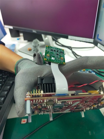

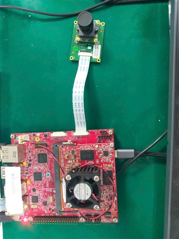

I am trying to bring up a Technexion TEVS camera module on the SK-AM68 (AM68A-SK) board using the official `tn,tevs` driver.
Current Status:
- PCA9543 I2C mux is working(`i2cdetect -y 3` shows 0x70).
- TCA6408 IO expander (`exp3 @ 0x20`) is working and GPIO hog is applied successfully.
- TEVS driver probes but cannot communicate with the sensor.
Problem: The sensor is not responding on I2C bus 4. No device appears at address `0x48`.
bash i2cdetect -y 4 (no 48 detected)

*What I have tried so far:
- Correct pinmux for reset pin (WKUP_GPIO0_70)
- Both GPIO_ACTIVE_HIGH and GPIO_ACTIVE_LOW for reset-gpios
- GPIO hog for CSI_VIO_SEL and CSI_SEL_FPC
- Removed standby-gpios temporarily
*Device Tree (latest version):

Hardware:
- Board: SK-AM68 (PROC125E2)
- Camera: Technexion TEVS (AR0522-M-S140-IR-RPI22)
- Kernel: TI Linux 6.1 (edgeai SDK)

    I have attached the latest DT file and full dmesg log for your reference.
    I would greatly appreciate any further support and guidance!
    Duc

    After setting it manually, I can confirm that gpio-480 shows out lo. However, the sensor still does not respond on I2C and the driver still fails to read register 0x3004.
    I have attached the latest DT (without CSI_VIO_SEL hog) and the current gpio status.
    Could you please advise what I should try next?
    Thank you very much!
    Duc

    I have continued debugging the TEVS-AR0522 on AM68 SK.
    Latest change:
    - Set CSI_VIO_SEL to LOW (1.8V) in the device tree as recommended.
    - Confirmed via /sys/kernel/debug/gpio that gpio-480 is now out lo.
    Current status:
    - CSI_VIO_SEL = LOW (1.8V) as required by the datasheet.
    - Driver still fails to read register 0x3004 (BOOT_STATE)
    - tevs bootup state remains 0xFFFF.
    Here is my latest device tree and current GPIO status.

  • Hi Takuma,
    Thank you for stepping in and helping.
    1. Physical connection
    - The camera is connected to J16 (CAM0 FPC connector) on the AM68-SK base board. I have attached a photo of the cable connection for your review. Regarding cable orientation: I inserted the FPC cable with the contacts (blue side) facing down toward the board. I followed the camera connection guide from Technexion for the AM69 board and applied the same orientation. Link: MIPI CSI-2 Cameras for Official TI AM69 / TDA4VH Starter Kit
    Could you please confirm if this orientation is correct for the AM68-SK board?
    2. I2C bus logs here are the requested logs:

    These are my current logs and photos. Could you please review them and give me some advice on what to try next?
    Thank you very much.

    Connection looks correct. The dmesg logs and i2cdetect logs looks like everything is working except for the reads to bus 4, address 0x48, which is where the camera should be. So, this reinforces that the issue is the camera looks to be "not existing" from Linux perspective.
    1. What is the revision of the board? There should be a sticker on the board that has something like PROC125E2, or E1, or some other number. Can you share the full string?
    2. Can you check with a multimeter to see if the CSI_MUX_SEL_2 (CSI_SEL_FPC_EXPn) signal is high? Should be able to probe on R219 on the board

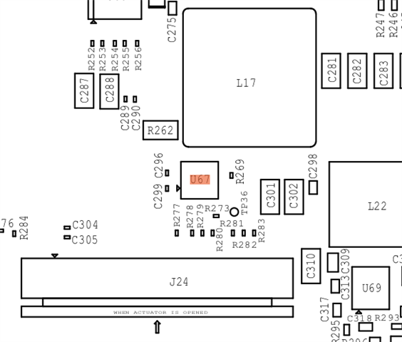

    Question: According to the schematic, WKUP_GPIO0_88 is for CAM0 and WKUP_GPIO0_70 is for CAM1. Previously I used WKUP_GPIO0_70 for CAM0. Now I will try using WKUP_GPIO0_88 as the reset pin for CAM0, together with standby-gpios = <&exp3 3 GPIO_ACTIVE_HIGH>.
    Do you think this configuration is correct?
    Here is the relevant schematic for reference:
    Thank you very much for your help.
    Duc
  • Hi Duc,
    The exp3 3 should be the correct pin for reset. I assume the pinout is the same as the RPI 22-pin camera module here: https://blog.arducam.com/raspberry-pi-camera-pinout/
    CAM0_GPIO1, connected to pin 17, should be power enable. WKUP_GPIO0_88, pin 18, should be LED-EN.
    You could try to probe the U67 GPIO Level Translation chip's pin 2 to get state of CAM0_GPIO1:
    Reference datasheet for which pin in pin 2: https://www.ti.com/lit/ds/symlink/txs0104e.pdf
