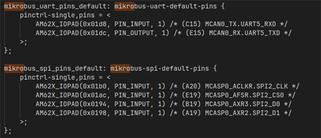

    DTS files and schematics show the following:
    The above tells you MikroBus Connector uses UART5 and SPI2.

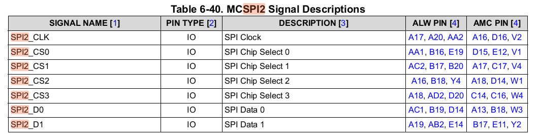

    Now you check the Datasheet for these pins:
    Take SPI2 example:
    Each SPI2 pin can be pinned out via multiple SoC balls as specified in:

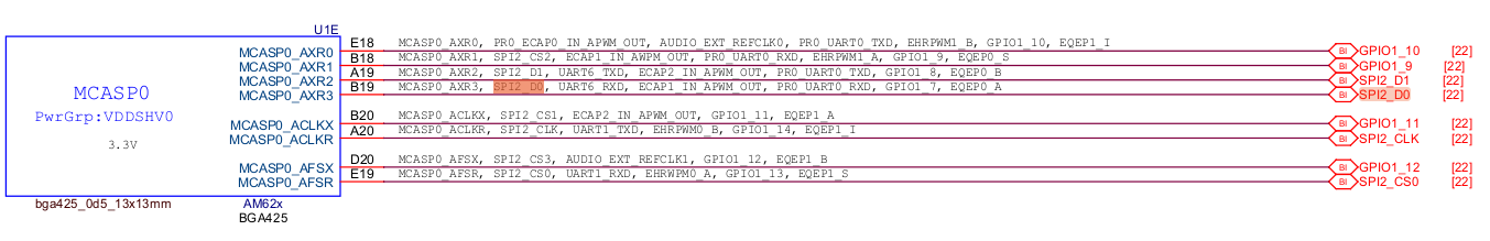

    But you need to identify which one your board is using. Let's say SPI2_D0, you can either trace this back on schematics (recommended) or check what's specified in DTS:
    Both will show SPI2_D0 is routed from ball B19.

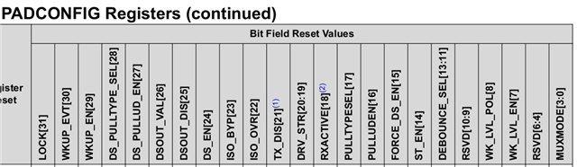

    These values fill in PADCONFIG register value per SoC pin as shared in the image of last response.
    You should be able to find macro definitions in driver to fill the same in arch/arm64/boot/dts/ti/k3-pinctrl.h
  • Dear Sir,
    From where can I get more information about this pad configuration register? How can I configure it according to our requirements? How should each bit be configured? I checked the datasheet, but I could not find this information. However, I was able to find the offset-related information in the datasheet.
