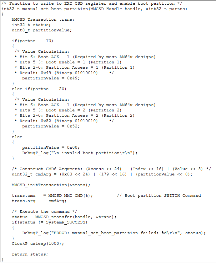

I am using TI mcu_plus_sdk_am64x_09_00_00_31 and using to generate keywriter binary for my AM6442 device. There is a requirement of switching the EMMC hardware boot partition from the keywriter program for which I used the api provided by sdk 'MMCSD_enableBootPartition' but on passing the partition number as 2 the boot partition 2 was not enabled. So I wrote some functions to read and write the EXTCSD register index 179 to switch boot partitions manually. Attaching the screenshot of the implementation. With these implementations I am able to switch boot partition. Please review and suggest any modifications if implementation is not correct. image.png

    If I compare your implemenation with the default MMCSD_enableBootPartition, I don't see any logical differences. Can you share the relevant logs showing the working case with your implementation and non-working case with the default MMCSD_enableBootPartition.

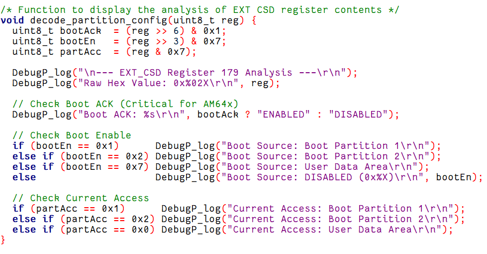

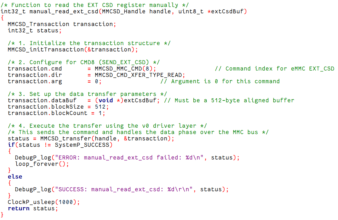

    As there is no api available to read the contents of EXTCSD register, I am sending MMC protocol command 8 from my application to read 512 bytes of EXTCSD register and then decoding the bits in 179 index to get the following parameter values
    Bit 6: Boot ACK
    Bits 5-3: Boot Enable
    Bits 2-0: Partition Access
    To switch the boot partition I am modifying the above bits in 179 index of the EXTCSD register by sending MMC protocol command 6 from my application and then verifying the changes by again reading back. Boot Enable and Partition access bits must have value 1 or 2 for active boot partition as 1 or 2 respectively. Boot ACK is always 1. In case of using sdk api MMCSD_enableBootPartition the Partition Access bits were 0(only 1 or 2 times I saw as most of the times application hangs). As this operation is busy wait operation there may be timing or sync issues. If I use my custom functions the application finishes every time with desired output.

    But, I do not see any logical differences between your "manual_set_boot_partition" and the default "MMCSD_enableBootPartition". If there are any, could you please list those?

  • It will take some time for me to validate with the UART related changes but these should not affect the functionality. We have keywriter image in partition 1 of EMMC and Linux image in partition 2. The api call with input as partition 2 must change the boot partition on next reboot but everytime the device was booting with keywriter binary.
    I observed the following differences : SDK api is modifying the register index 177 also to set boot bus width. I have given extra 1 second delay after calling my function.
    I wanted to know that if we use our custom function to do the same will this cause any issue? We may modify our keywriter application in future to add some more functionality so if we keep it like that it will be helpful for us. We just wanted to get our changes in keywriter application to be reviewed. Let me know if it is correct to use the sdk to build our custom application.
  • SDK api is modifying the register index 177 also to set boot bus width.
    This is required so you must also do the same in your implementation.
    If this is working then you may do the same for the default SDK function.
    In any case, you may continue with your implementation but it should also modify the boot bus width similar to how it is modified in the default SDK function.
