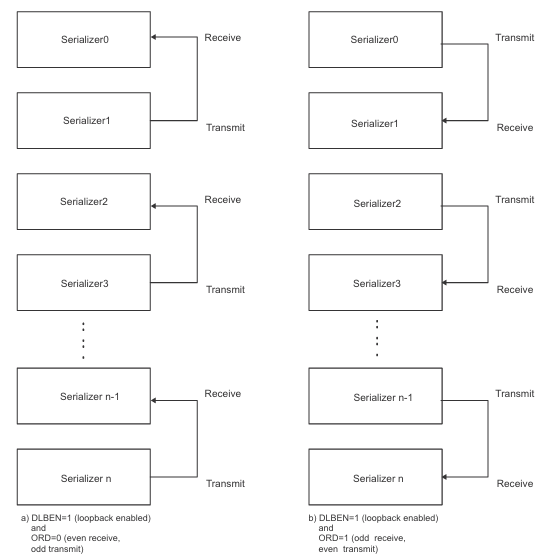

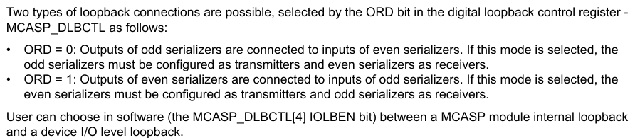

is it possible to connect serializer 1 and 2 in loopback mode?
Or does loopback only work in pairs like this: 0-1; 2-3; 4-5 ...
In the TRM it only shows the connections 0-1, 2-3, 4-5 but it does not show 1-2, 3-4 etc.
