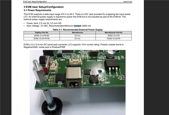

  • Hello praveen,
    We have flashed the provided images onto the SD card; however, we are still facing the same reset issue.
    Then it is hardware issue.
     We are currently using a 12V, 2.5A power adapter.
    I don't think this will be sufficient.
    As i mentioned above
    The supply voltage has to be 12V and 5A
    Even TRM document it is mentioned the same
    Tarun Mukesh
  • Hi Tarun,
    We are using the SK-TDA4VM starter kit hardware. Even after loading the default images shared by you, we are still observing a reset issue.
    Please confirm have you tried on same SK-TDA4VM starter kit ?
    Praveen
  • Hello Praveen,
    For SK kit there is no RTOS SDK support itself from TI . It is only a starter kit . Since you mentioned EVM we are discussing about EVM.
    SK-TDA4VM: These boards are designed primarily for edge AI. While the SDK RTOS contains DSP libraries (C7x/C66x) used for the edge AI subsystems, TI does not provide official, out-of-the-box support for user-defined RTOS binaries on the SK variant (as this board is a hardware subset of the full-fledged TDA4VM-EVM) .
    Tarun Mukesh
