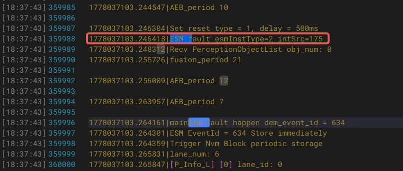

After enabling inline DDR ECC, we conducted stress test and encountered an ECC error interrupt,
When inline DDR ECC is disabled, there are no abnormalities when using memtester. May I ask if the margin is insufficient, or if the timings are too aggressive?

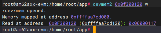

DDR Enable Procedure:
1. Set DDR ECC config in SBL1
2. Apply the patch
/cfs-file/__key/communityserver-discussions-components-files/791/ddr_5F00_11_5F00_1.patch
3. Update dtb in u-boot-spl & u-boot & kernel
4. Reading register 0x0f300120 shows that ECC is enabled.
memtester test method:
root@am62axx-evm:/userdata# devmem2 0x0f300120 w
/dev/mem opened.
Memory mapped at address 0xffff8dcbd000.
Read at address  0x0F300120 (0xffff8dcbd120): 0x00000117

  • Hi XUE,
    The Teye_micron_2GB_1600.pdf show much wider eyes on each of the bits than Teye_micron_2GB_1865.pdf.  Although it is difficult to determine if this is because of the frequency difference or a configuration difference.
    I would recommend continuing to debug with the configuration i gave you, and try to figure out the illegal access interrupt.  It looks like is that something to do with an ESM event, although i don't know why you would his this error with the DDR config i gave you, it should not have mattered.  Maybe you can disable this event for now or somehow determine why you are getting this interrupt.  If you can provide a full log, maybe our software team can help.
    James

  • Hi XUE,
    let me ask a few more questions to get some context:
    -it appears you are using SBL to boot into linux.  What is this log from?  It doesn't look like a linux log.  Is this some monitoring log running from R5?
    -This snippet is from the u-boot dtb, but that is irrelevant since you are using SBL.  Can you show the change you made in the kernel dtb?
    -When the ECC occurs, can you show the log in linux?  The memtester log you posted doesn't show any memtester errors.
    -Does linux crash when the ECC errors occur?
    -What is your system doing when the ECC errors occur?  For example, are you just running memtester when the errors occur?  Are you performing any application level operations?  For example, any data transfers with other peripherals in the system?  How many processor cores are executing at the same time?
    -you indicated a temperature sensitivity.  So do you ramp the temperature and start seeing failures?  Or are you booting and running at a certain temperature?
    -you mentioned you were getting both correctable and uncorrectable errors.  Are you able to boot and run for some time before hitting the uncorrectable errors?  Or do these errors occur during boot and you system just never can get through the boot stage?

  • Hi Jamms
    1. We boot using the SBL, and that log originates from the R-core. We have enabled ESM ECC fault detection on the R-core; a reset signal is generated when an ECC fault is triggered.
    2. The modifications in the kernel are similar to those in U-Boot, limiting the total memory size.
    3. The Linux system exhibits no abnormalities when an ECC error occurs.
    4. The Linux system did not crash.
    5. Our application running on the A-core utilizes shared memory for inter-core communication with the R-core. We have observed that all memory regions reporting DDR ECC errors are located within this specific shared memory area. What could be the cause of this?
    6. We also encounter this issue at around 60°C; temperature does not appear to be the definitive cause.
    7. The system operates normally for a period of time before an ECC error occurs.
    Best regards!
    XUE Fadong
  • Can you give us more details on the scenario which causes these errors.  What type of communication are you performing between A53 and R5?  What type of data is being shared?  Is there any handshaking or semaphores to ensure A53 and R5 are not accessing the same region at the same time?  What is the nature of the shared data (element size, block size, structures, single data words, etc)?
    James
  • Just a follow up here, we'd like to reproduce this failure on our EVM if possible.  If you have an EVM, we can really accelerate the debug if you can reproduce this on an EVM, or give us enough information about the failure scenario so we can try to reproduce it.
    James
