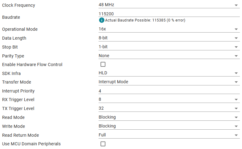

SysConfig Settings for Problematic UART
uart4.inputClkFreq     = 160000000;
uart4.baudRate         = 10000000;
uart4.sdkInfra         = "LLD";
uart4.readCallbackFxn  = "Callback_rx4";
uart4.writeCallbackFxn = "Callback_tx4";
uart4.$name            = "CONFIG_RS422_4";
uart4.intrEnable       = "DISABLE";
uart4.UART.$assign     = "USART3";
uart4.UART.RXD.pu_pd   = "pu";
uart4.UART.RXD.$assign = "UART1_CTSn";
uart4.UART.TXD.$assign = "UART1_RTSn";

    I am not sure if the UART Baud rate settings are correct here. Could you please try with a default configuration which is mentioned as follows:
    I would have you try with blocking mode and basically the setting as shown above in the screenshot.
    Let me know if it works for D16 --> UART RXD?
    Also if you can share a screenshot of the UART code which does the receive part in your application, that would be really helpful. Basically the part that does Uart Transaction Init and the UART_read call.
    Looking forward to your response.
    Vaibhav
