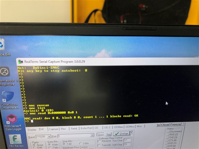

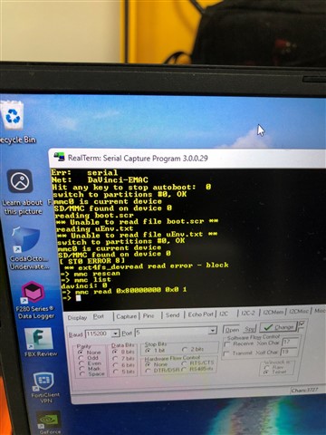

Helklo, I am using OMAPL138 SoC from ages on a product and recently we upgraded them to use industrial SD cards. This seem to work but every now and then it fails to read SD card.
couple of images attahced, please let me know if there is a way to debug this.
Failed:
Passed:
  • Only the failed image came through.
    Let me check on the error and get back to you.

  • Thanks Paul.
    attached passed image.

    This is a 'random' failure on one SD card or multiple?
    Does this issue happen on multiple boards or just one?
    If just one card,  have you tried re-flashing and re-testing?
    Does moving the failing card to a different board have the same result?
    it is possible that the new cards use a controller that has marginal interoperability issues.
    --Paul
  • Hi Paul, same SD card fails on multiple boards.
    there are some SD card that works always and some that works few times and fails.
  • Mitesh
    Definitely sounds like marginal timing on the SD card.
    Some vendors use different internals/controllers under the same model and/or modify the internals over time.
    It would be worth exploring an alternate make/model of SD card
    --Paul

  • Hi Paul, tried some debug,
    we ran following U-Boot commands on a working and non working sd-card bit from same manufacturer :

  • Hello Mitesh,
    Apologies for the delayed responses here. Please keep in mind that U-Boot 2017 is too old for us to support on the forums, and we are limited in the support we can offer for OMAP-L138 as per the support banner on the ti.com page.
    Just to make sure I understand: Are you thinking of manually testing SD cards one-by-one by plugging them into a board to see if the board boots or not? And then trying to speed up that process by running a test in uboot? (which does not make sense now that I mention it since you could just look for the read errors in your initial screenshot)
    Or are you asking for something else, like if there is a test you can run to measure an SD card's controller timing to see if the card has potential to fail during boot, or if the controller timing is "safe"?
