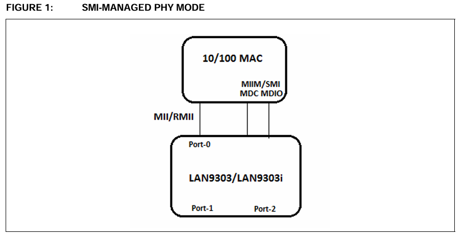

Hello experts,
We have an AM62P on our custom board. On CPSW port 2 we have connected an external ethernet switch from Microchip, LAN9354, over RMII. It is managed over mdio. The picture below depicts our setup:
The switch works correctly in U-Boot and also in Linux if I omit the DSA driver. It then performs as a normal unmanaged switch with two ports.
When I add the DSA driver snippet in the dts, the chip seems to be probed correctly, but I get no connectivity on my two user ports.
The probing itself seem a bit shaky. Some boots it doesn't succeed and falls back to the unmanaged mode. All the data lines and clock lines have been reveiwed for trace length matching.
Here are some relevant snippets:

    SDK version is 11.02.11, Linux kernel 6.12.57
    How are you the DSA driver snippet in the DTS? Is it part of the lan9354_swtich DTS settings?
    This row pulls in the driver:
    compatible = "microchip,lan9354-mdio";
    Anyway, the problem is now solved since I found the errata J2329 that clearly states that the MDIO implementation is flawed and needs to be bit-banged.
    FFR:
    static const struct soc_device_attribute k3_mdio_socinfo[] = {
    	{ .family = "AM62X", .data = &am65_mdio_soc_data },
    +	{ .family = "AM62PX", .data = &am65_mdio_soc_data },
    	{ .family = "AM64X", .data = &am65_mdio_soc_data },
    	{ .family = "AM65X", .data = &am65_mdio_soc_data },
    	{ .family = "J7200", .data = &am65_mdio_soc_data },
    	{ .family = "J721E", .data = &am65_mdio_soc_data },
    	{ .family = "J721S2", .data = &am65_mdio_soc_data },
    	{ /* sentinel */ },
    Add the above line in davinci_mdio.c and the mdio bus will work as it should.
    /B
