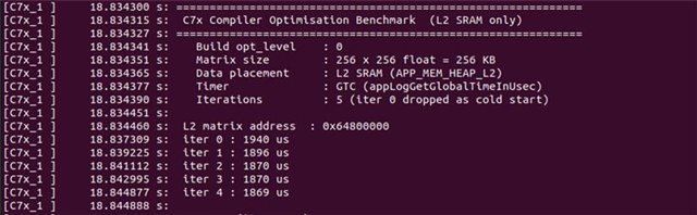

    uint64_t t_start, t_end;
    t_start = appLogGetGlobalTimeInUsec();
    /* code under test */
    t_end = appLogGetGlobalTimeInUsec();
    elapsed_us = t_end - t_start;
    3) Invoke the benchmark function after appInit() and before appRun() in vision_apps/platform/j784s4/rtos/c7x_1/main.c
    4) Allocate benchmark data in L2 SRAM
    float *l2_mat = (float *)appMemAlloc(APP_MEM_HEAP_L2, size_in_bytes,alignment)

    4) Verify the optimization results in the terminal output.
    The optimization levels achieved by running this kernel for different optimization levels(0 to 4) are as follows:
    Optimisation Level Cycle count
    0 1889
    1 1622
    2 47
    3 24
    4 24
