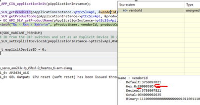

when I load the esi file (xmf) from the TIEP example into the Beckof TwinCat , i gets this message:
Ok the Vendor ID's don't fit. But why?
In the xml file:

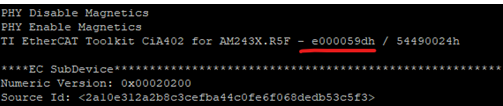

The EtherCat CPU shows:
However, I only find in the source code:
This is where the ECAT_VENDORID is set:
read and print:
Where does the "E" come from?
Could it be that the reading routine getVendorId cheats this "to it", but contains the ID without "E" in the structure, and is also transmitted to the TwinCat in this way?
Unfortunately, I am not able to resolve the routine EC_API_SLV_getVendorId().

  • Hello Alexander,
    TI as a technology provider delivers EtherCAT SubDevice with a secondary vendor ID 0xEXXXXXXX. Please refer to the EtherCAT Vendor ID related FAQs here.
    Please note that 0x0000059D is the primary vendor ID of TI and 0xE000059D is the secondary vendor ID. All EtherCAT SubDevice examples in Industrial Communications SDK will have 0xE000059D (secondary vendor ID) as configured vendor ID, when examples are compiled with prebuilt eval version of Beckhoff SSC library provided within the SDK.
    When the examples are compiled with licensed version of Beckhoff SSC library (customer generated) then the examples will be configured with primary vendor ID defined by the macro 'ECAT_VENDORID' (customers need to replace with their own vendor ID). Please update the vendor ID field in the ESI file as well. Make sure to reload the device descriptions in TwinCAT and also remove any online device description files created earlier.
