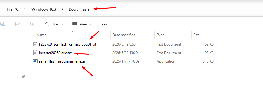

I am using F28379D control Card (TMDSCNCD28379D) and try to use C2000 F2837xD_sci_flash_kernels_cpu01 to practice the boot loader process.
So far, I have successfully imported the "F2837xD_sci_flash_kernels_cpu01 - [Active-CPU1_RAM]" into my workspace and build the project successful.  the txt file has been builted.
My application file, which is called "Inverter2025Slave.txt", is also generated.  For my convenience, I put the utility file, the kernel txt file and app txt file in the same folder, see below.

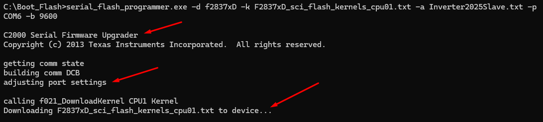

In the command window, I typed following command:
the screen response me the following message:
I waited forever without further indication.

My question is:  1) Why is the programmer waiting forever?  How do I know what is going on?
2) Did I miss some setup?
