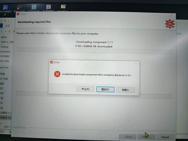

    When customer tried to install edge AI studio MCU, it needs internet access to download some dependency but customer's computer can't access Internet so it stuck here. I also could not find MCU Analytics Backend installation package in internet.
    Could you help to check if we have separated installation package that can solve this issue? And what's other dependency customer needs to install in advanced?
    Best Regards
  • Hi Kita,
    Yes, the "MCU Analytics Backend" are downloaded during installation. The packages are portable, so I can provide a version of the package that can be shared with the customer if needed. It is a big package though (~5GB).
    In the meantime, I can also look into an enhancement in future releases to remove the online requirement during installation (but the install package will be a lot bigger in that case).
    Other dependencies include the specific SDK and compiler based on the device the customer is using. I can provide specific packages needed if the customer already knows which device/device family they will be developing on.
    Ricky
