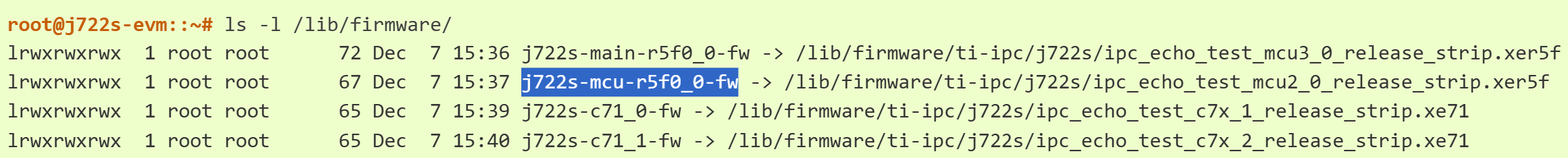

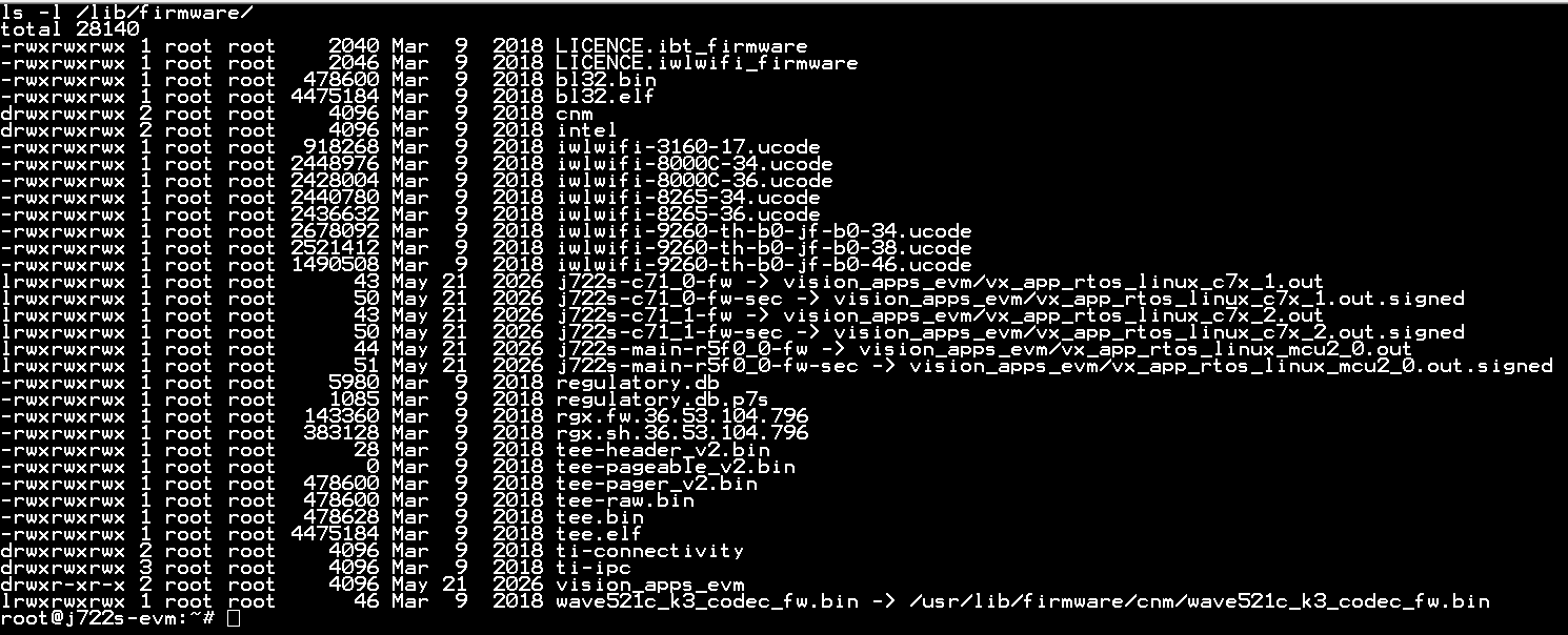

I would like to test the MCU1_0 firmware update status within visionapps by updating the firmware.
However, after executing the command ls -l /lib/firmware/, the j722s-mcu-r5f0_0-fw file is not listed or shown in the directory.
Could you please guide me on how to properly test MCU1_0 by replacing its binary file under this circumstance? What are the correct steps or workarounds to achieve this?
