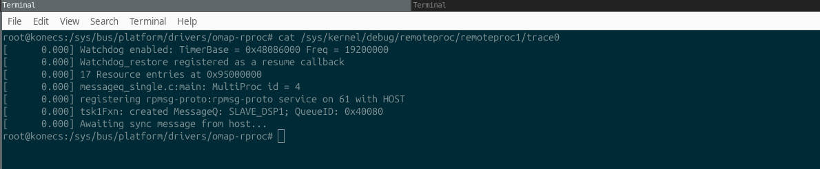

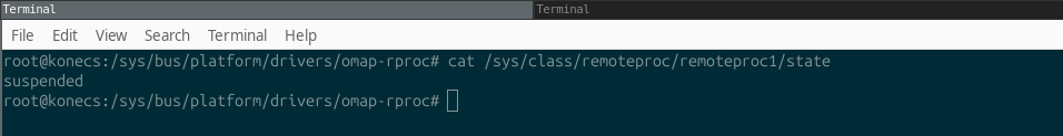

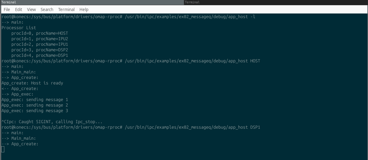

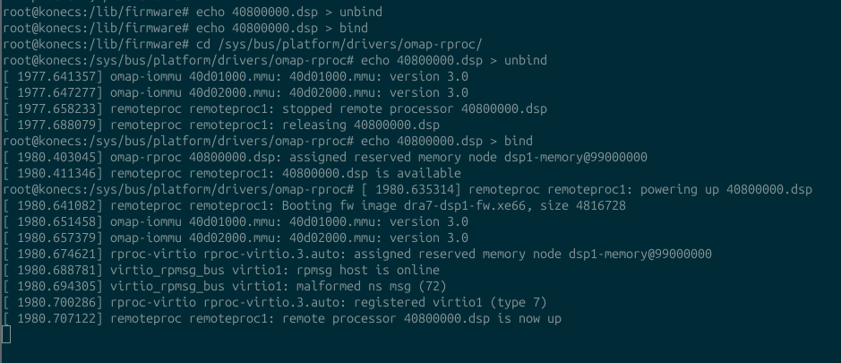

Hello TI team,
I am in the process of setting up IPC between custom Linux application and custom firmware built using code composer studio but it didn't yield expected outcome due to IOMMU fault.
 Their software stacks should be compatible since the buildsystem which build the Linux application is based on TI's 11.01 Processor SDK Linux (IPC stack version 3.52.00.01) and the firmware is based on TI's 5.01.00.11 Processor SDK RTOS (IPC stack version 3.52.0.00).
In order to verify IPC between the A15 host core and TMS320C66x DSP remote core, I have opted to run the example Linux application (app_host) and example firmware (messageq_single.xe66) but I was unable to establish proper message exchange between the cores even though LAD successfully recognizes all the cores. Also, the firmware is up and running but hadshake is nonetheless not possible. See the following figures for more troubleshooting context:
I have ran the NameServerApp application which ran successfully indicating that the IPC stack on the Linux side should be functional which lead me to conclued that the issue stems from the fimware side of the stack:
