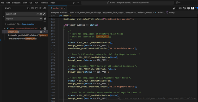

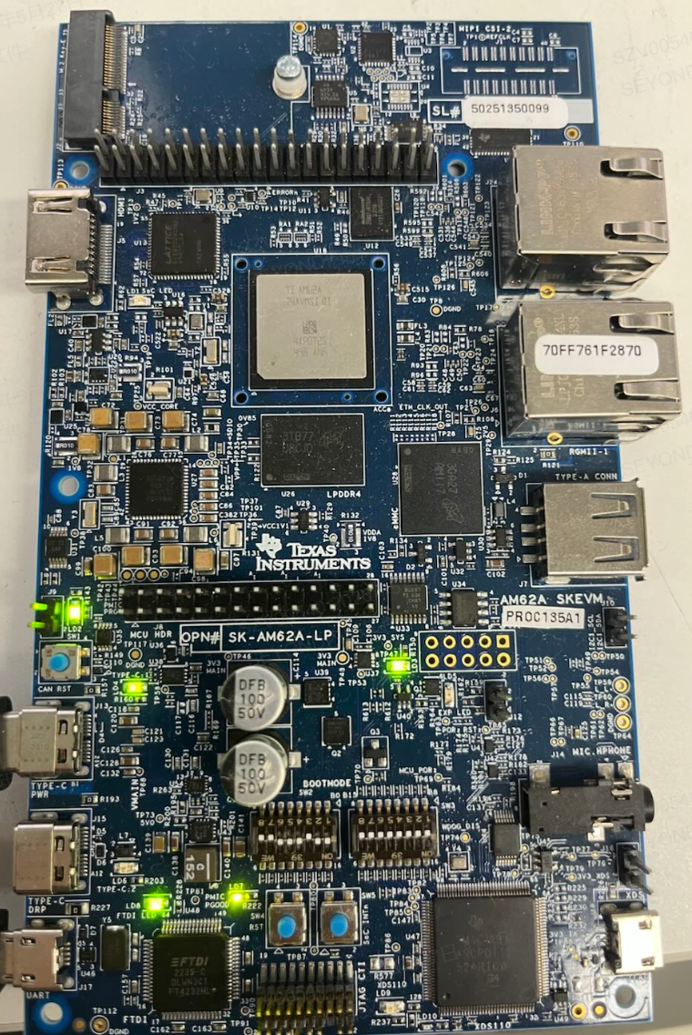

Use default_sbl_ospi_nand_linux_hs_fs.cfg to flash image into AM62A EVM.
I integrated the pbist_mpu_example_am62ax-sk_mcu-r5fss0-0_nortos_ti-arm-clang into ipc_rpmsg_echo_linux_am62ax-sk_mcu-r5fss0-0_freertos_ti-arm-clang.
Pbist test failed.
The failed log is below.
PBIST Test Application
 Starting PBIST failure insertion test on A53 MPU CLUSTER0, index 0...
  Sciclient_pmSetModuleState 0x88 ...FAILED
  Delta Cores prep time in micro secs 1261
  Delta PBIST execution time in micro secs 183
  Delta Cores restore time in micro secs 7540
 PBIST complete A53 MPU CLUSTER0, test index 0
PBIST Functionality Test Failed.
Some tests have failed.
