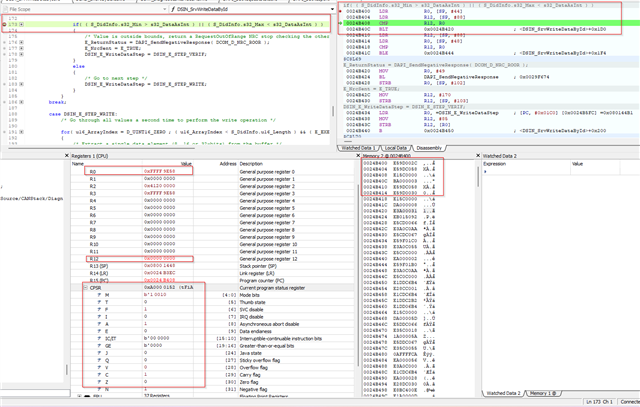

We have a simple test case to compare 2 signed int which fails.
For example, this:
if( ( S_DidInfo.s32_Min > s32_DataAsInt ) || ( S_DidInfo.s32_Max < s32_DataAsInt ) )
This test is used to check if the value is in the range.
For which you have a structure S_DidInfo with MIn and Max field as signed long, and s32_DataAsInt a variable also as signed long.
We have a basic function case for which min is -25000 and max is 25000, and the s32_DataAsInt is equal to 0.
So we have:
( -25000 > 0 ) || ( 25000 < 0 ), and the result of this if test is TRUE.
I cannot explain this behavior.
Is there an know issue on signed comparaison for the version ti-cgt-arm_20.2.7.LTS?
Any advice or comment on that?
I have added the debug info, we can see the R0=0xFFFF9E58 (-25000) and R12 = 0. The screen is after the CMP, but before the BLT executions.
After the BLT execution, we go at 0x24B420, so, inside the if branch as if the condition is true, while it is not.
I was not able to interpret the OP code your can see in memory window, I can find the proper doc I guess.
Thanks for your feedback.

    After further discussion we identified that this issue is only persistent with the use of breakpoints during debug.
    Handing off to our experts in the product line that can better help with understanding breakpoint behavior.
