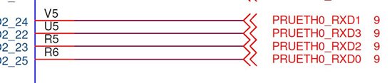

Dear TI Support Team

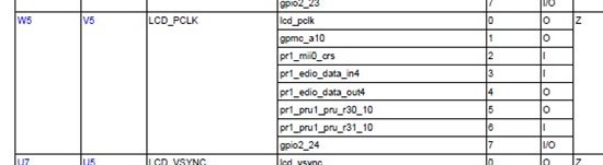

I have just checked the AM3359 ICE Schematic (Rev. A2) and I have tried to follow the Pin assignment with the Pin Mux Utility (Version 2.2.1.0). Now I have seen the the ICE is using the ZCZ package and connects PRUTH0_RXD1 signal to pin V5. But Pin V5 is not a PR1 MII0 RXD1 pin according to the Pin Mux Utility and according to the Datasheet (sprs717b). PR1 MII0 RXD1 should connect to U3?
With ZCE package V5 would be ok according to the datasheet.
Can you tell me what's wrong and what's right?
