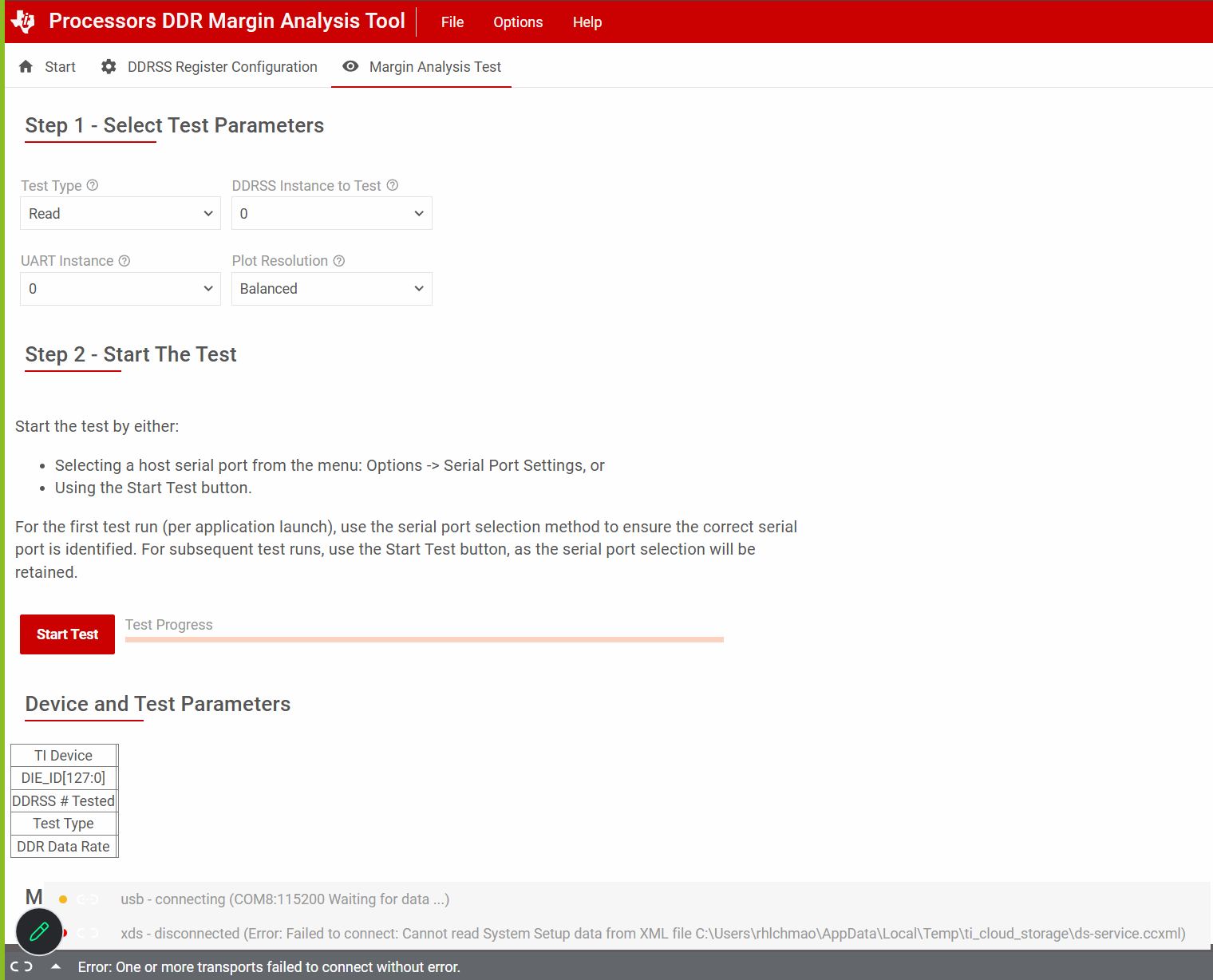

Hi there,
I tried to use the DDR margin analysis tool with debugger USB560v2 and it failed the JTAG connection as shown in the screenshot. How to fix the problem?
Charles

  • Hi Kevin,
    We did use XDS-110 this time and it didn't work either. The same error messages popped up- "Error: Failed to connect: Cannot read System Setup data from XML file C:\Users\rhlchmao\App|data\Local\Temp\ti_cloud_storage\ds-service.ccxml". I can confirm the file exists. Somehow, this forum doesn't allow me paste that file's content here. Can you provide any tips regarding the failure? How to troubleshoot it?
    To use the DDR margin analysis tool, is there any special preparation needed for my custom board, such as boot mode, boot configuration, etc?
    Charles
    No, unfortunately someone from our CCS team would need to help troubleshoot.
    A few suggestions I can think of while I request additional help:
    • Try deleting the ti_cloud_storage subdirectory (from the AppData\Local\Temp folder) and then re-try
    • Try uninstalling TI Clout Agent ( C:\Users\<userID>\TICloudAgent\uninstall.exe), then reinstalling by running the tool again
    Please note that after reinstalling TI Cloud Agent, it takes a while (several minutes) for the tool to run background processes on the first launch. First files have to be installed, and then the first launch takes a long time to load. Please do not interrupt this process.
    Kevin
    Here is input I received from our CCS team:
    Please enable cloud agent logging by removing “REM” from the following lines in ticloudagent.bat file. It should be located in C:\Users\rhlchmao\ticloudagent
    rem set TI_DS_ENABLE_LOGGING=1
    rem set TI_DS_LOGGING_OUTPUT=c:/temp/my.log
    Please make sure c:/temp exists and look for new .log files being created and send those.

  • Thanks, please see the feedback below.
    I would suggest that customer:
    • Close the app… maybe all browser tabs
    • Run fsclean command (highlighted below in bold green)
    • Open the app again, select device and connect (this should trigger that same process) that can take quite some time and wait for progress to finish. If it finishes quickly, there is a possibility that some download error happened.
    0x0000176C 84051 3  JSON R: {"data":{"message":"Cannot read System Setup data from XML file C:\\Users\\rhlchmao\\AppData\\Local\\Temp\\ti_cloud_storage\\ds-service.ccxml\nCould not fetch next record for SQL statement (database disk image is malformed)\nIf this continues, please run fsclean located at C:\\Users\\rhlchmao\\AppData\\Local\\TEXASI~1\\TICLOU~1\\loaders\\ccs_base\\common\\bin\\","messageAlreadyReported":false},"error":3}
