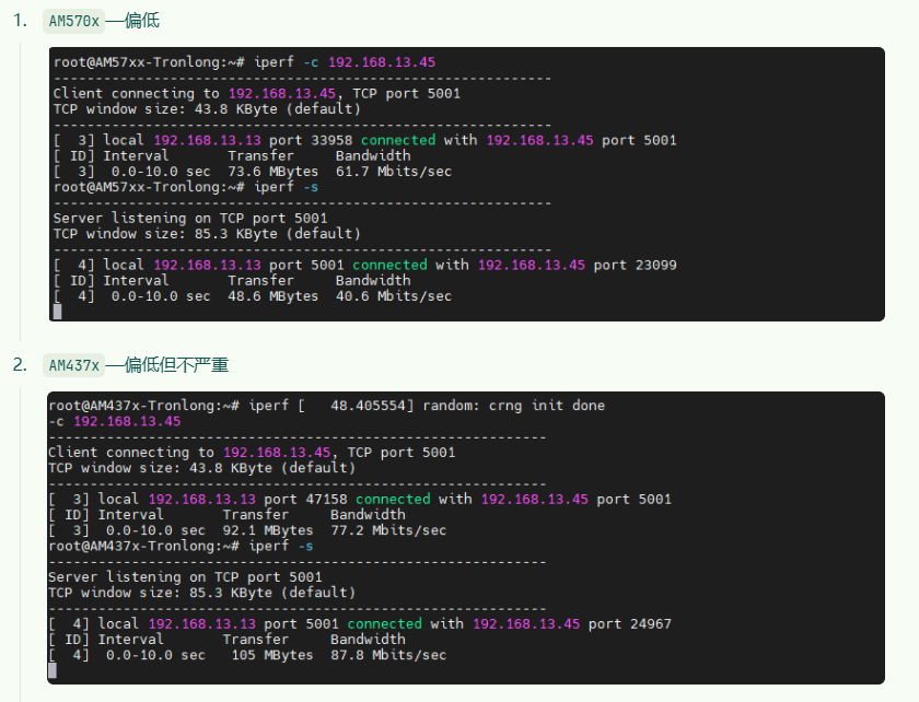

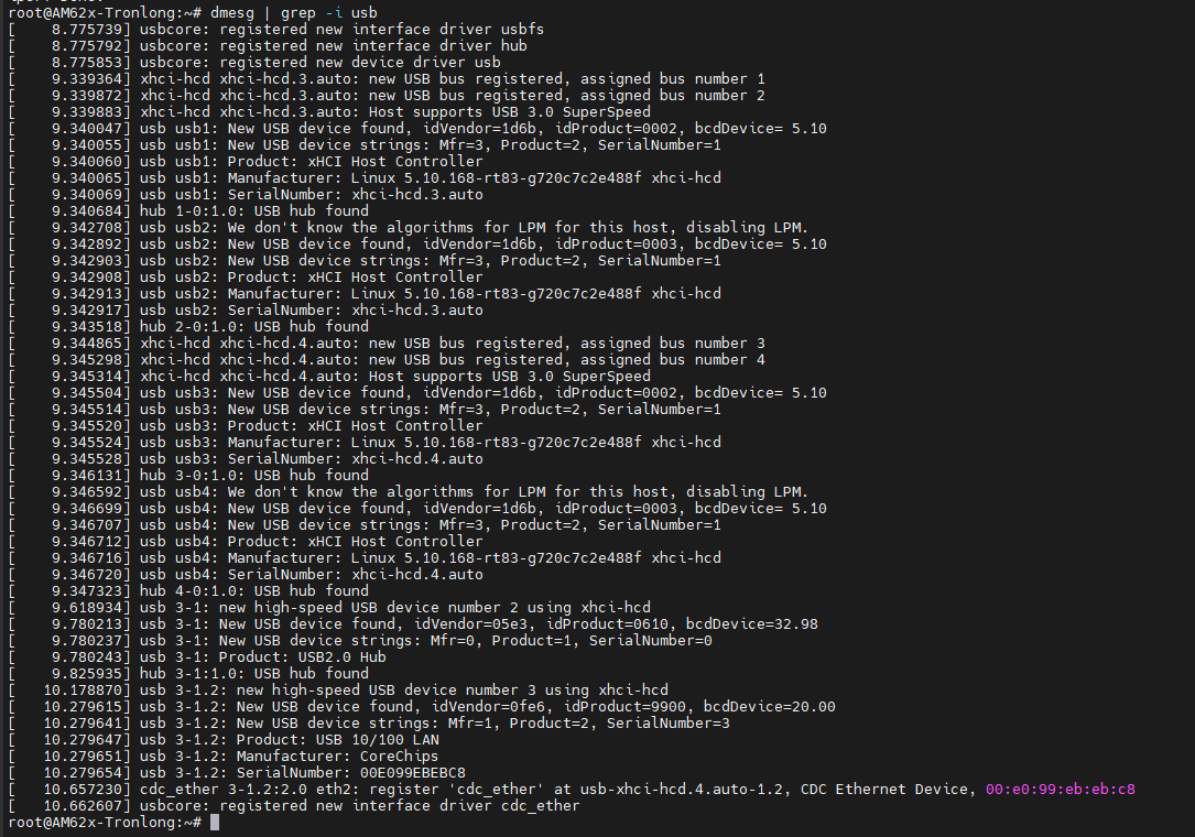

On the same board with the same USB port. with SR9900 module, the speed is lower compare with other USB to LAN module(SMSC95xx)
am62x+ SR9900AI: iperf3, throughput low
There is not USB error also:
AM62x + SMSC95xx: iperf, throughput normal

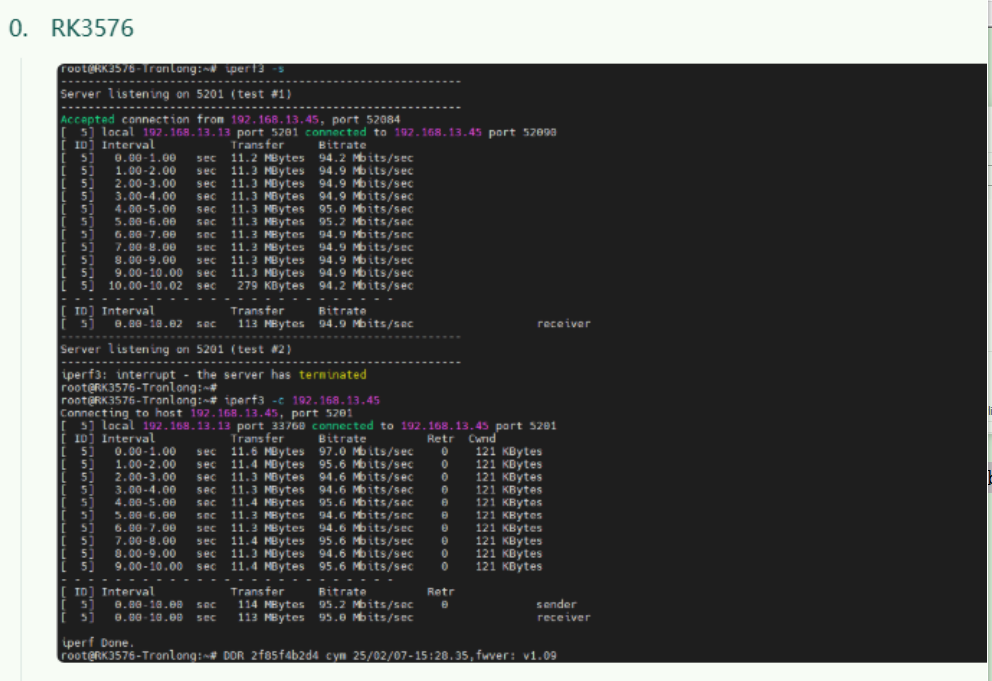

RK3576 + SR9900AI, iperf3, normal.
Test with: Processor_sdk_09_02_01_09(Kernel 6.1.80) and Processor_sdk_08_06_00_42(kernel 5.10.168)

  • Hi Bin,
    Customer tested am6254 with sdk5.10.1689iperf) and sdk6.1.80(iperf3), the result is similar.
    More test with competitor sdk, result are normal.
    RK3576 + Kernel 6.1.115, iperf3
    RK3562 + Kernel 5.10.209. iperf3
    Allwinner T113 +kernel 5.4, iperf3
    am5728 and am4378: iperf,  with SR9900AI, result are low,
    CH397A USB LAN dongle, with AM57x, AM62x, T113, RK3576, all normal.
