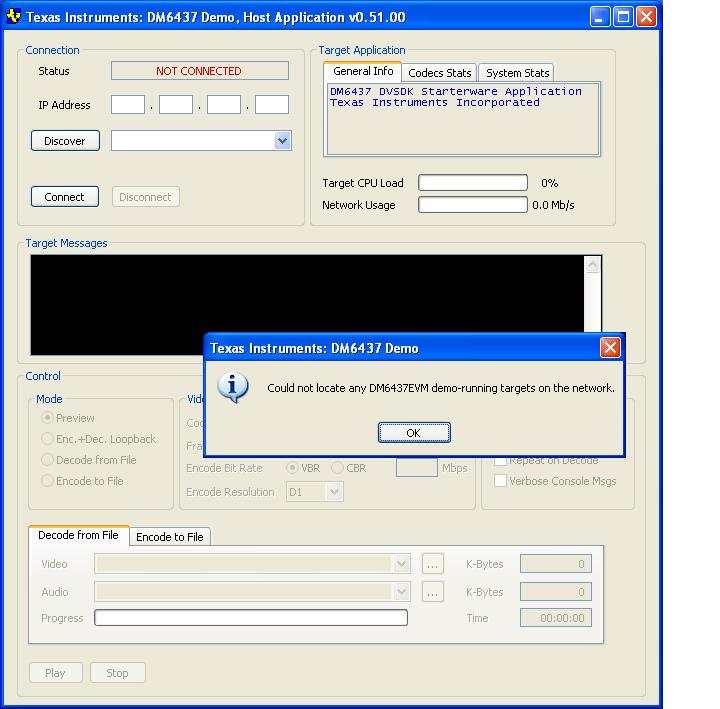

I received this Pop up Error message when I click Connect Button:
  • ERROR: could not connect to the target at IP 192.168.1.101
  • Details: JavaException: java.net.connectionException: Connection timed out: connect
I received this Pop up Error message when I click Discover Button:
             Could not locate any DM6437EVM demo-running targets on the network.

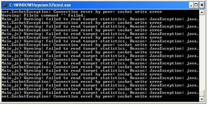

Second, I was able to compile the VLIB_testExamples successfully  but was not able too see any results when running.
Perhaps there is some configuration that I missed or did not set up a proper test harness.
(Please see attached pictures.)

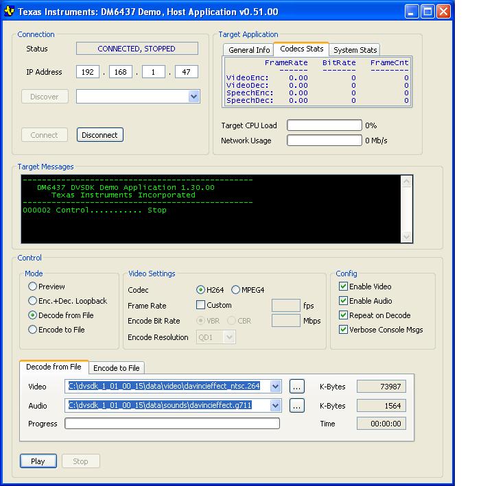

  • Hi
    I started with two issues and was hoping to get some support in evaluating this TMS320DM6437 board.
    I was able to  resolve my first issue on my own but am running into some issues with the Host App.
    Decode from File Mode
    I selected Video h.264 and Audio G.711 but the Host App appears to have issues decoding these Video and Audio files.
    Is there another work around?
  • Greetings Ken!
                I am Barani. i am working with DM6437 evaluation board. I tried to run the host side demo application  from the hostapp directory. I used the run.bat file to run the demo. When i tried to find the ip address of the EVM board through the discover option. I got the error message
    I came to know through this forum that you solved this issue.
    I just installed the softwares and ran the batch file. Other than that i didn't do any changes regarding the demo application.
    Can you kindly tell me, how to solve this problem. Whether i have to update the gel or what else i have to do to solve this issue?
    Kindly assist me in this case.
    Barani.
