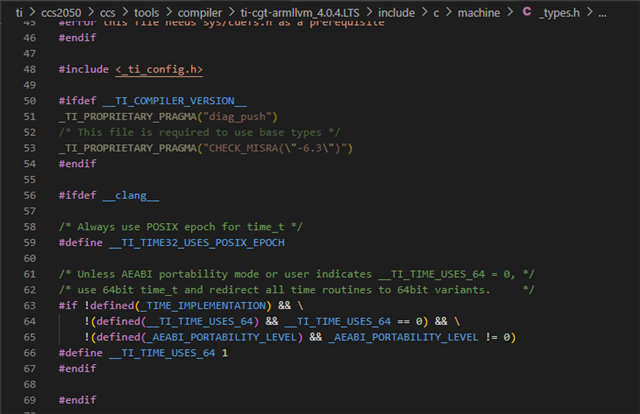

  •  , I would like to make sure I understand this more and implementing correctly. Without the #define __TI_TIME_USES_64, should I expect the structure size to be 32-bits and when the #define is activated, it should be 64-bits?
    #include <stdio.h>
    #ifndef __TI_TIME_USES_64
    #define __TI_TIME_USES_64 1
    #endif
    #include <time.h>
    void verify_time_configuration(void)
        printf("=== TI Time Configuration Test ===\n");
        // 1. Check size of time_t (Should be 8 bytes for 64-bit)
        printf("Size of time_t: %d bytes\n", (int)sizeof(time_t));
        if (sizeof(time_t) == 8)
            printf("[SUCCESS] time_t is a 64-bit integer.\n");
        else
            printf("[WARNING] time_t is 32-bit. __TI_TIME_USES_64 is not active.\n");
        // 2. Check the Epoch (Should result in 1970 standard)
        // 0 seconds from the 1970 epoch is Jan 1, 1970.
        // If it is using the legacy 1900 epoch, 0 seconds would print Jan 1, 1900.
        time_t test_epoch = 0;
        struct tm *epoch_time = gmtime(&test_epoch);
        if (epoch_time != NULL)
            printf("Epoch baseline year: %d\n", epoch_time->tm_year + 1900);
            if (epoch_time->tm_year + 1900 == 1970)
                printf("[SUCCESS] Using correct POSIX 1970 Epoch.\n");
            else
                printf("[WARNING] Using legacy %d Epoch.\n",
        else
            printf("[ERROR] gmtime failed to process timestamp.\n");
        printf("==================================\n");
    When I use the above code and run without #define and with #define activated, I seem to get the same results. Am I missing something fundamental?
    CORTEX_M0P: [SUCCESS] time_t is a 64-bit integer.
    CORTEX_M0P: Epoch baseline year: 1970
    CORTEX_M0P: [SUCCESS] Using correct POSIX 1970 Epoch.
    CORTEX_M0P: ==================================
  • The behavior is the same with or without your #define because __TI_TIME_USES_64 is already defined to 1 by the compiler's own RTS header before your code is processed.
    machine/_types.h (part of the TI Clang RTS) defines __TI_TIME_USES_64 1 for ARM EABI targets. This header is pulled in transitively when anything includes <time.h>. So for any ARM Cortex-M target built with TI Clang, 64-bit time_t with the 1970 POSIX epoch is the default — no explicit #define is needed.
    You cannot get 32-bit time_t on this target without actively opting out. If you ever need the old behavior (32-bit, CST 1900 epoch), you would have to pass -D__TI_TIME_USES_64=0 as a compiler flag.
