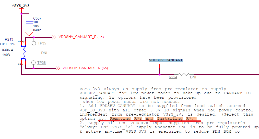

We study TDA4EVB SCH (E3B), PROC170E3B(002)_SCH.pdf
We still do not understand why should we need to remove R78 & add R77.
Need you explain more detial.
Thank You.
Gibbs
  • The schematic note is out of date, specifically the resistor reference designators.  Its is referring to the two resistors shown just above the note, specifically R213 and R224.
  • Hello, Robert
    Thanks you replies.
    If TDAEAEN do not need to low power mode, that's mean VDDSHV_CANUART can connect to VDDIO_3V3.
    So we can remove R213 and add R224.
    If I say anything wrong, please correct my comment.
    Thank You.
    Gibbs
  • That is generally correct.  However the EVM is setup to use the lower power mode. So there could be other potential issue(s).  For example - some of the IO on the VDDSHV_CANUART rail are pulled up to VSYS_3V3 (always on power).  When moving VDDSHV_CANUART to VDDIO_3V3, the pull-ups could cause voltage domain leakage (which PMIC might detect as residual voltage error).  TI has not tested this configuration change.
