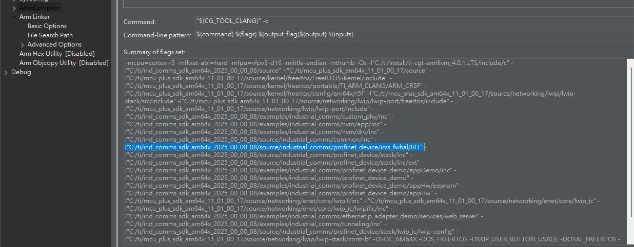

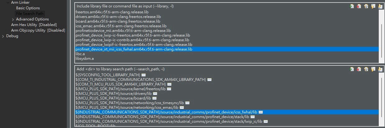

1. Environment & Configuration
Platform: AM64x
Library Linked: ⁠profinet_device_irt_mii_icss_fwhal.am64x.r5f.ti-arm-clang.release.lib⁠
Include Path: ⁠source/industrial_comms/profinet_device/icss_fwhal/IRT⁠

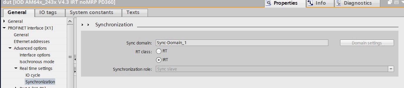

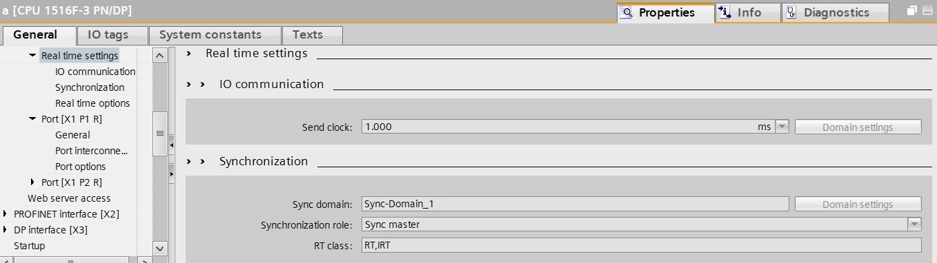

2. PLC & GSD Setup
PROFINET Interface: RT Class = IRT | Sync Role = Sync Master | Send Clock = 1 ms
GSD File: * ⁠SupportedRT_Classes="RT_CLASS_1;RT_CLASS_3"⁠
⁠IsochroneModeInRT_Classes="RT_CLASS_3"⁠
Note: TIA Portal imports the GSD successfully and allows IRT selection without issues.

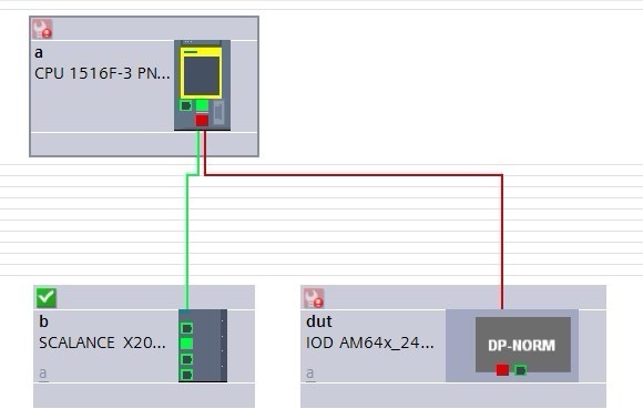

3. Observed Behavior

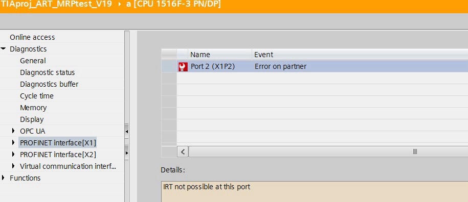

Working: The device comes online normally. DCP functions properly, IO Device can establish RT communication, and standard RT data exchange works without issues.
Failing: When switching to IRT, the RTC3 communication fails to establish.
4. Diagnostic Errors
PLC Diagnostics (Port 2 / X1P2): Shows the error message "IRT not possible at this port."
PRONETA Diagnostics: * LLDP RTClass3 Status: Abnormal
PTCP Sync: Not established
RTC3 connection: Not established
