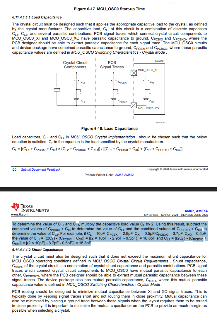

Seems there is a discrepancy with the load calculation for the AM67.
The equation your AM67 datasheet is displaying right below figure 6-18 seems to not
follow the standard equation C_L = ((C_L1 * CL*2)/(C_L1 + C_L2)) + C_stray + C_pin...
Could you please clarify the calculation provided in 6.11.4.1.1.1 of the AM67 Datasheet?
  • Hello Nicolas,
    The equation in the AM67x Datasheet in section 6 Specifications, point 6.11.4.1.1.1 Load Capacitance is correct and consistent with the standard crystal load capacitance formula. Rather than lumping parasitics into a single C_stray + C_pin term, TI's equation explicitly accounts for the PCB trace parasitics (C_PCBXI and C_PCBXO) and device pin capacitances (C_XI and C_XO) separately for each signal node. This is actually more accurate, as it gives the designer full visibility into each parasitic contribution. There is no discrepancy- the formulas are mathematically equivalent.
