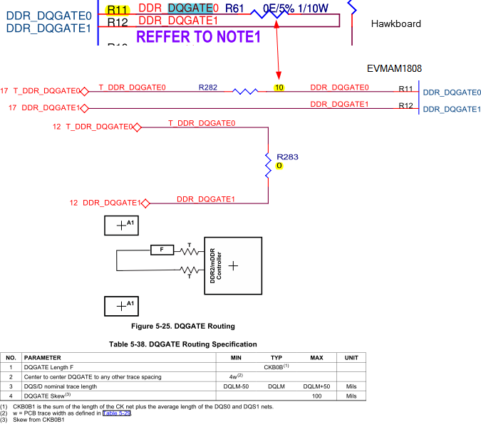

I would like to ask a question on the resistor for OMAP L138 DDR2 controller’s DQGATE net class:
  1. On p.139 of L138 datasheet there is no specification on resistor value.
  2. In EVMAM1808 the combined resistance of two resistors (R282 & R283) is (10=10+0)Ω.
  3. In Hawkboard it is marked as 0E, which I suspect might be 0Ω.
Is there any requirement on this? Why EVMAM1808 and Hawkboard are different on this?
