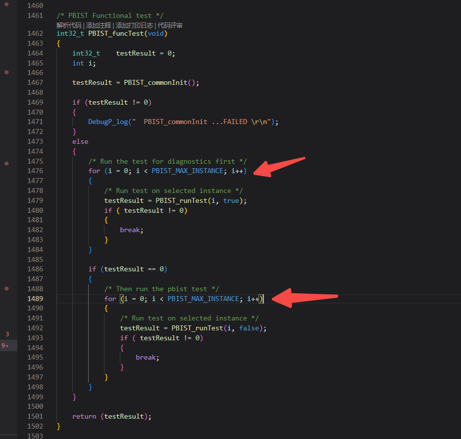

Hello. I referred to the Pbist example in the SDK and attempted to run Pbist in SBL, where SBL runs on the wkup-r5fss0-0 core. The execution cases of Pbist include SDL_PBIST_INST_MPU ~ SDL_PBIST_INST_MCU, totaling 12 instances.
Our tests revealed that after executing the cases SDL_PBIST_INST_WKUP_PBIST1 and SDL_PBIST_INST_MAIN, there would be problems with the loading of the OSPI image, as shown in the following error message: ASSERT: 0.636553s: ospi/v0/dma/udma/ospi_dma_udma.c:OspiDma_udmaUpdateSubmitTR:243: FALSE failed!!! .
Therefore, I would like to inquire: Is this a normal phenomenon? Which PBIST instances can be executed within the SBL?
