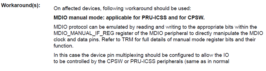

    The CPSW3g and PRU-ICSS MDIO hardware should allow a maximum MDC frequency as high as 2.5 MHz as per the AM64x Datasheet MDIOs timing characteristics, but according to the AM64x Silicon Revision 1.0,2.0, in the  AM64x SoC SR1.0 (silicon revision) and latest SR2.0, there are hardware limitations over the frequency because of issues described within the: Advisory notes i2329 and i233.
    For more information on these limitations and how to apply the MDIO manual mode workaround to allow MDIO operation, please refer  to the Advisory notes i2329 and i2331 of the AM64x Silicon Revision 1.0,2.0.
    Here is an excerpt of what is important from the i2329:
    The manual mode MDIO driver with a software bit-banging of the MDC signal shall be used. This means that the clock shall NOT be generated through the MDIO hardware state machine, which shall be disabled, but with a software thread directly toggling the MDC pin in the enabled MDIO manual mode. Therefore the MDC pulse sequence frequency performance  may depend on the CPU workload over time.
    You may want to refer the below thread for more information on how to achieve a sufficient MDIO.MDC clock frequency. Despite, it is regarding AM620-Q1, the described erroneous behavior and workaround are identical:
    AM620-Q1: Errata i2329, Threads regarding changing MDIO MDC frequency
    AM625: MDC frequency in manual mode
    Please consider also the i2331 advisory workaround - when accessing the  CPSW3g / PRU-ICSS MDIO or other registers right after PORz event.
