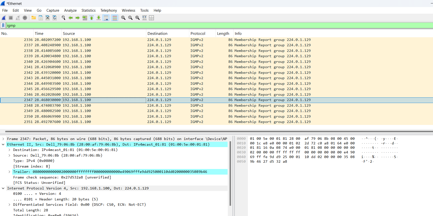

  1. It appears that when passing IGMPv2 messages in a DLR ring, the device will corrupt the message and then re-transmit it indefinitely. It’s especially concerning as the Device is originating the messages even after the IGMP source device has been taken offline.
  2. Then for reproducing the issue I tried one other method. Device's one ethernet/ip port is connected to one switch and other port connected to another switch. For generating IGMP messages I am using one python script IGMP_Transmit.zip . As soon as we start to send IGMP messages and check wireshark log on both switches (as attached in image)  Igmp_v2_wiresharklog_port1.zip  wiresharklog_port2.zip
    image.pngwe can see errorous messages in the repeted manner. This is only stop when we power off the device.

    I set up a comparable test on my side using the same SDK version and an LP‑AM243x target. I could not reproduce the problem; the IGMP messages pass through without corruption or duplication, regardless of the multicast address or the message type (query, leave, or report).
    Did you also test on an LP‑AM243x, or only on your custom hardware? (I don’t expect the hardware to be a factor, but I’d like to understand any differences in our test setups.)

  • Hi Yashaswini,
    The problem appears to stem from the use of an incorrect multicast address.
    The address 224.0.1.129 is reserved for PTP and must not be used for IGMP traffic. In my setup, packets sent to this address are not forwarded at all. I cannot explain why they are forwarded in your case—different TimeSync (PTP) settings could be the cause. Most likely the ICSS/PRU treats the packet as a PTP message and applies PTP‑specific forwarding, which would produce the altered and duplicated frames you observed on the opposite port.
    Please try the following:
    1. Use a legitimate IGMP multicast address (e.g., 224.0.0.2) and check whether the behavior changes.
    2. To pinpoint the discrepancy between our results (no forwarding on my side versus duplication on yours), let me know the state of your TimeSync feature: is it enabled or disabled? Any additional configuration details specific to your implementation would be helpful.

    We tried the following things
    1. Use a legitimate IGMP multicast address (e.g., 224.0.0.2) and check whether the behavior changes.When we used this multicast address(224.0.0.2) errarenous messages were not there and only one time message is forwarding
           2.To pinpoint the discrepancy between our results (no forwarding on my side versus duplication on yours), let me know the state of your TimeSync        feature: is it enabled or disabled?
         Enabled

    1) Then it confirms my suspicion that the IP address used for IGMP was interfering with PTP.
