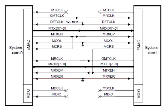

I am trying to connect two AM389x processors using the EMACs:
Can you help resolve these questions:
1)      Is the phy in the new AM389x equivalent to that used in the DM6467?
2)      What are the details for using the EMACs for MCU to MCU Communication?
3)      Does EMAC_CRS get tied to GND or does it tie to the same MCUs RXDV?
MPU 1
Direction
MPU 2
Notes
EMAC Module
EMAC_TXCLK
I
Unused on both
EMAC_GMTCLK
O
EMAC_RXCLK
Cross Clocks
EMAC_TXD[0-7]
O
EMAC_RXD[0-7]
Crossed data
EMAC_TXEN
O
EMAC_RXDV
Cross ETn/RVa
EMAC_COL
I (GND)
Ground Both
EMAC_CRS
I (???)
GND or EMAC_RXDV_1
Please see attached diagram

Please see:
Inter-DM6467 Communications Using Direct GMII Connections (RandyP)
SMTS FAE
http://e2e.ti.com/cfs-file.ashx/__key/CommunityServer-Discussions-Components-Files/717/2480.Inter_2D00_DM6467-Communications-Using-Direct-GMII-Connections-E2E-.pdf
