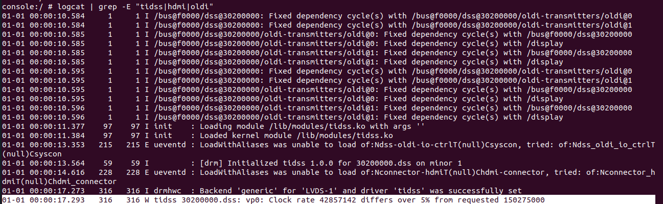

We are currently working on LVDS display panel 1P.NVDA-TM2118SA123L-03 bring-up on the AM62P5 EVK using the Android SDK (version 11.00.01).
For this setup, we are using the DTBO overlay k3-am62p5-sk-microtips-mf101hie-panel.dtso. Additionally, we have disabled the HDMI bridge (sii9022) in the base device tree file k3-am62p5-sk.dts.
However, we are facing an issue where the clock configurations appear to be incorrect, and the LVDS panel is not displaying any output in Android.
There is mismatch in the clock for the odi1 transmitter

    Is this a custom Android build? If so, did you try running with only the default k3-am62p5-sk-microtips-mf101hie-panel.dtbo overlay to check that shows no error on your setup?
    You should not see the oldi-io-ctrl error which is causing the clock rate error in your case. Also, incase you really wish to remove HDMI, I still see an HDMI connector based error. Though harmless, you may have missed removing the HDMI connector node.

    As per your suggestion i disabled the hdmi connector in the dts file.Now no error logs related with hdmi.But we find a syscon error and still we are not obtaining the android display over the LVDS.How can we eliminate this syscon error.Following are the logs:
    console:/ # logcat | grep -E "tidss|oldi|hdmi"
    01-01 00:00:09.638 1 1 I /bus@f0000/dss@30200000: Fixed dependency cycle(s) with /bus@f0000/dss@30200000/oldi-transmitters/oldi@0
    01-01 00:00:09.638 1 1 I /bus@f0000/dss@30200000: Fixed dependency cycle(s) with /bus@f0000/dss@30200000/oldi-transmitters/oldi@1
    01-01 00:00:09.638 1 1 I /bus@f0000/dss@30200000/oldi-transmitters/oldi@0: Fixed dependency cycle(s) with /bus@f0000/dss@30200000
    01-01 00:00:09.638 1 1 I /bus@f0000/dss@30200000/oldi-transmitters/oldi@0: Fixed dependency cycle(s) with /display
    01-01 00:00:09.638 1 1 I /bus@f0000/dss@30200000/oldi-transmitters/oldi@1: Fixed dependency cycle(s) with /bus@f0000/dss@30200000
    01-01 00:00:09.638 1 1 I /bus@f0000/dss@30200000/oldi-transmitters/oldi@1: Fixed dependency cycle(s) with /display
    01-01 00:00:09.649 1 1 I /bus@f0000/dss@30200000: Fixed dependency cycle(s) with /bus@f0000/dss@30200000/oldi-transmitters/oldi@0
    01-01 00:00:09.649 1 1 I /bus@f0000/dss@30200000: Fixed dependency cycle(s) with /bus@f0000/dss@30200000/oldi-transmitters/oldi@1
    01-01 00:00:09.649 1 1 I /bus@f0000/dss@30200000/oldi-transmitters/oldi@0: Fixed dependency cycle(s) with /bus@f0000/dss@30200000
    01-01 00:00:09.649 1 1 I /bus@f0000/dss@30200000/oldi-transmitters/oldi@0: Fixed dependency cycle(s) with /display
    01-01 00:00:09.649 1 1 I /bus@f0000/dss@30200000/oldi-transmitters/oldi@1: Fixed dependency cycle(s) with /bus@f0000/dss@30200000
    01-01 00:00:09.649 1 1 I /bus@f0000/dss@30200000/oldi-transmitters/oldi@1: Fixed dependency cycle(s) with /display
    01-01 00:00:10.427 96 96 I init : Loading module /lib/modules/tidss.ko with args ''
    01-01 00:00:10.433 96 96 I init : Loaded kernel module /lib/modules/tidss.ko
    01-01 00:00:11.788 223 223 E ueventd : LoadWithAliases was unable to load of:Ndss-oldi-io-ctrlT(null)Csyscon, tried: of:Ndss_oldi_io_ctrlT(null)Csyscon
    01-01 00:00:11.942 12 12 I : [drm] Initialized tidss 1.0.0 for 30200000.dss on minor 1
    01-01 00:00:16.341 321 321 I drmhwc : Backend 'generic' for 'LVDS-1' and driver 'tidss' was successfully set

    console:/ # cat /sys/kernel/debug/clk/clk_summary | grep dss
    clock-divider-oldi-dss1 0 0 0 42857142 0 0 50000 Y deviceless no_connection_id
    clk:186:6 1 1 0 320000000 0 0 50000 Y 30200000.dss fck
    clk:186:2 0 0 0 300000000 0 0 50000 Y 30200000.dss vp2
    clock-divider-oldi-dss0 1 1 0 42000000 0 0 50000 Y 30200000.dss vp1
    We changed the clock frequency to 42Mhz by updating the panel-simple.c driver.Now the previous error clock rate rate differs is removed.

  • Hi Vysakh,
    Please share the git diff instead of the whole files.
    If you also have the SK-AM62P TI EVM, is it possible to first try out with the Yocto image? It will be easier to isolate the issue there.
  • Hi Divyansh
    Our development is based on the Android SDK Image 11.00.01 for the EVM AM62P and we need the display to be bring up on Android platform,not Linux.
    We are having the following error which is related with the syscon.Any idea about solving this.Without solving this,we think the oldi transmitters will not be properly configured.
    Attaching the log of the diff for the generic driver panel-simple.c

  • Okay, assuming the above are your only changes, let me try replicating this internally. Please expect a response by mid next week.

  • Hi Divyansh,
    We tried the same changes in the dts file and still we are facing the same issue of syscon failed.
    Any update of recreating the same issue  from your side and any solution for this?

    There is no change in the k3-am62p.dtsi file.
    And the overlay file is implemented in the base dts file K3-am62p5-sk.dts and its patch is attached below:

  • Hi Vysakh,
    Can you please share the complete files instead of the diff? It will help me better evaluate your issue.
  • Hi Vysakh,
    Our Android expert is currently out-of-office, but he will most likely recreate Android (Default 11.00.01 SDK) + SK-LCD1 (and eventually your panel configs as well) at his end by end of this week. I think this has been tested multiple time already and there are customers using this already, but we'll confirm just in case.
  • Hi Vysakh,
    Closing this ticket as you mentioned issue resolved with modified configuration.
  • Hi Divyansh ,
    Thank you Divyansh for your support
    We were able to successfully bring up the LVDS channel on the AM62P EVK. The display output is now working after updating the configuration and hardware settings.
