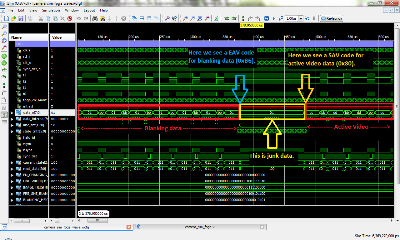

  • I am working with Craig on this problem.  We have found that on the eval board, without driving TIM4_OUT (SYNC_DET on daughtercard) with a HSYNC like signal, one can not capture frames.  We are awaiting feedback from TI on if/where this is documented and how to get around this for an encoder that doesn't have the same signal.  We hope that embedded syncs are supported without the need to drive this pin, but are awaiting some help with this.
    We have forwarded your query to our local board team here. Waiting for their reply. Embedded sync capture without that pin should also be supported.
    Hardik Shah
  • Hardik,
    We saw this behavior (with TIM4) a few days ago, but now are unable to reproduce the behavior.  Yesterday we were able to capture from a FPGA without driving TIM4.  That may be a false alarm.  It still would be good to know if this pin is used on the reference design/with the M3 core.
    - Thad
  • Anyone who can help...
    We have noticed that when we are capturing, the register at address 0x48105a30 has the size of the image we are trying to capture.  With our current setup, the first four hex digits = the width/2, while the second four hex digits = # of lines.  So for a 640 x 480 image, we would get:
    48105a30:  014001E0
    We are able to capture into the eval board with this through a FPGA and our camera.  The FPGA is basically passing the signals through.
    On our board we see the following.  Our camera is putting out a 636 x 480 image.  The register at 0x48105a30 outputs the correct line width of 318 (636/2), but the # of lines continuously increments by 480 (so counts 0x1E0, 3C0, 5A0, etc with rollover) .  This makes me think that whatever interfaces to these registers is capturing data.  Does anyone have an idea what would cause this behavior and how we can get HDVPSS/TI code to pass us a frame?
    We can't figure out what we are doing wrong.
    - Thad

  • For everyone who can't sleep at night because of the VIP and is following this post...  :)
    We think that the reason we are getting rollover in the lines portion of the memory dump is because of the data our sensor (OV7740) is putting out.  I have attached a FPGA simulation that depicts what the data from our camera looks like.  This seems to cause the TI core to hang while capturing and the counter to roll over.  I have seen that if the SAV code in the picture is for blanking data, the TI core will still capture.  This is what we have seen using a FPGA we wired into the evaluation board to simulate our camera.  It captured fine until I added this junk data to it's output.
    There is one other observation we made while debugging.  We haven't definitely proven this, but with a line length not divisible by 4, the TI core/driver/something seemed to hang.  The OV7740 was also conveniently putting out 1279 bytes/line in YUV mode, which seemed to break things.
    Have fun!  If you're really stuck, I think Craig and I would recommend finding yourself a FPGA and someone who knows Verilog to try things to see what breaks the TI core and what works.  Half the errata on this device (the 8168) seems to pertain to the VIP core.
    - Thad
