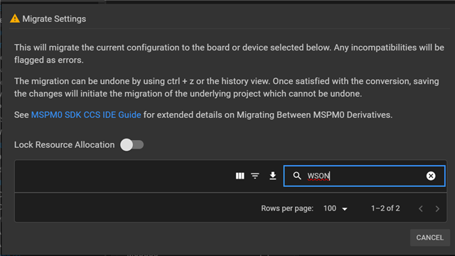

I'm using CCS + SysConfig with MSPM0C1104.
Even when creating a new empty project, SysConfig always shows:
MSPM0C1104
VSSOP-20 (DGS20)
Is there a way to change the package in SysConfig and view the correct pinout for the 8-pin DDF package?
Or is only the DGS20 package currently supported in SysConfig?
Thanks.
  • Hi Willie,
    The different package for MSPM0C1104 (including DDF) are supported to switch in Sysconfig.
    Which CCS and sysconfig are you using?
    I try with my current CCS 20.5 and sysconfig 1.26.0 version, and the MSPM0C1104 package could be switched in below interface:
  • Hi Pengfel,
    My CCS version is 20.5.0.28, and SysConfig is 1.26.2 version.
    When I click Swtich button shows under windows, but there isn't any options to choice.
  • Hi Willie,
    Could you also share your SDK version? I think CCS and sysconfig version are high enough. And below is the migrate settings from my side.
    And I recommend you to import an empty project from SDK and check it again but not create one by yourself.
  • Hi Pengfei,
    Thanks for your help, I have already switched the package.
    When I drag the IDE window from my notebook screen to an external monitor,
    It looks like the window size is fixed. I had to connect a larger monitor in order to scroll down and access the content at the bottom.
