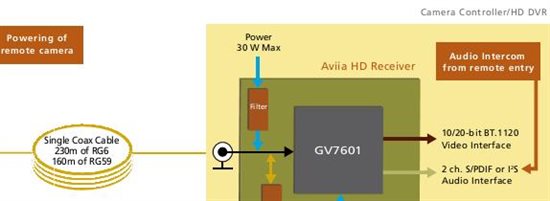

In Gennum doc,GV7601 can send 10bit BT.1120(alse can be 8bit with lowest 2bit unused) .

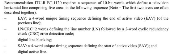

    this photo is from BT.1577.          BT.1120 is 10bit word.
    Peason3: From the GV7601 doc,just the picture I posted.10Bit BT.1120

  • Hi answers embedded,
    SuitJune Young said:
    I mean that BT.1120 is 10Bit or 8Bit?
    BT1120 is 16 or 20 bit.
    "Which spec did you check for BT1120? What I found in BT1120 spec is that the video data is 8-bit or 10-bit words. So there is no problem for DM368 to receive the BT1120 format data." By Chris Meng Ti FAE
    BT1120 standard is a part of ITU standard. I dont think specs are free.
    I think you are confused between word size and interface size. For BT1120 and BT656 both you can have word size as 8/10. But for BT656 Y and UV will be transmitted to VIP as 8-bit parallel interaface with Y and UV time multiplexed with double the clock frequency. For BT1120 Y and UV will be transmitted as 16-bit parallel interface with 1X clock frequency. VIP supports both.
    Hardik Shah
