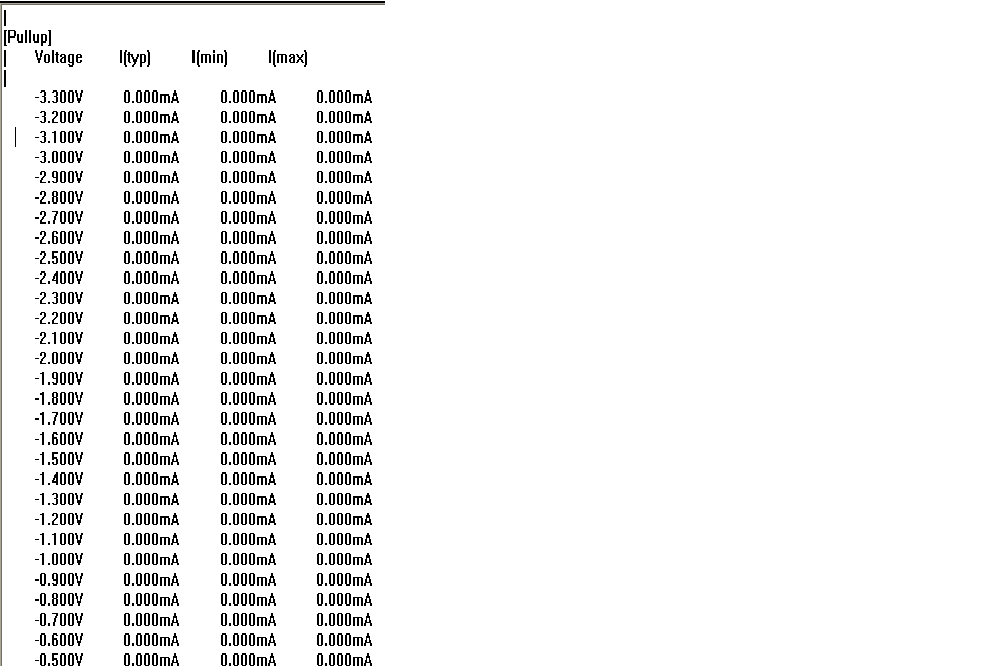

Problem with sprm129a.ibs model of TMS320VC5502PGF300
There are errors with the PULL UP characteristics of model  idi091_uos205 in sprm129a.ibs model of TMS320VC5502PGF300.
Current is 0.0ma in Pullup for open_drain/Open_sink device.
Check the attached snap for the problem I mentioned above.
Please provide some appropriate guidance and arrange a proper IBIS Model for the same.
