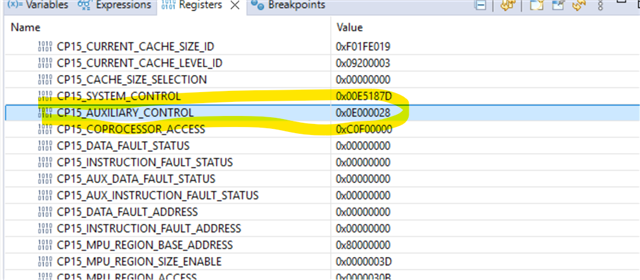

  • Hello Anil,
    My use case is related to Worst-Case Execution Time (WCET) analysis for a safety-critical application running on the AM2432 Cortex-R5F.
    The objective is to understand and, if possible, reduce the timing variability introduced by the branch prediction mechanisms. Since branch predictors depend on execution history and internal microarchitectural state, execution time can vary depending on the contents of structures such as the Branch Target Buffer (BTB), Branch History Table (BHT), and other prediction-related resources.
    For the WCET analysis, I am evaluating two possible approaches:
    1. Disable branch prediction completely, if supported by the device, so that branch behavior becomes more deterministic and independent of predictor state.
    2. Characterize the worst-case predictor state, if branch prediction cannot be disabled, to determine the maximum execution-time penalty caused by branch mispredictions.
    Any guidance on the recommended configuration for deterministic execution on the AM2432 Cortex-R5F would be greatly appreciated.

  • Hello Karila Palma Silva,
    I have reviewed the R5F core settings in the MCU+ SDK, and by default, the branch prediction setting is disabled.
    Please review the register configuration below.
    Therefore, you do not need to modify any register bits to disable branch prediction manually
    Anil.
