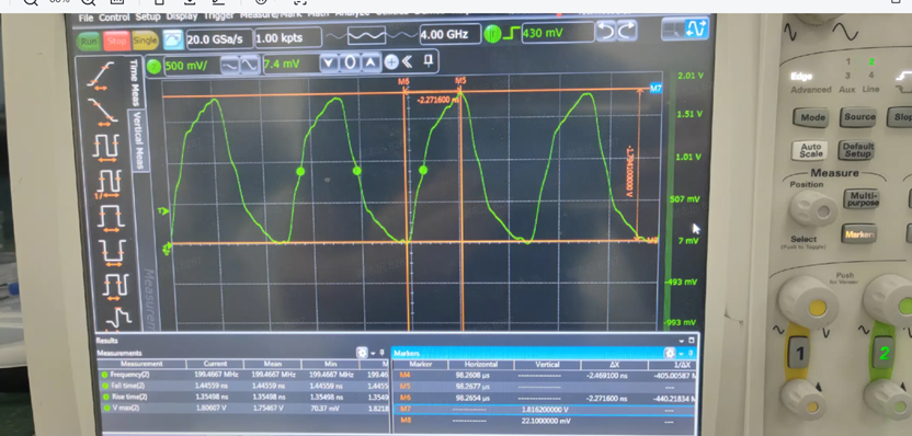

On custom board, the eMMC_CLK slew rate is 0.8V/ns, even can't meet eMMC device's requirement of 1.125V/ns.

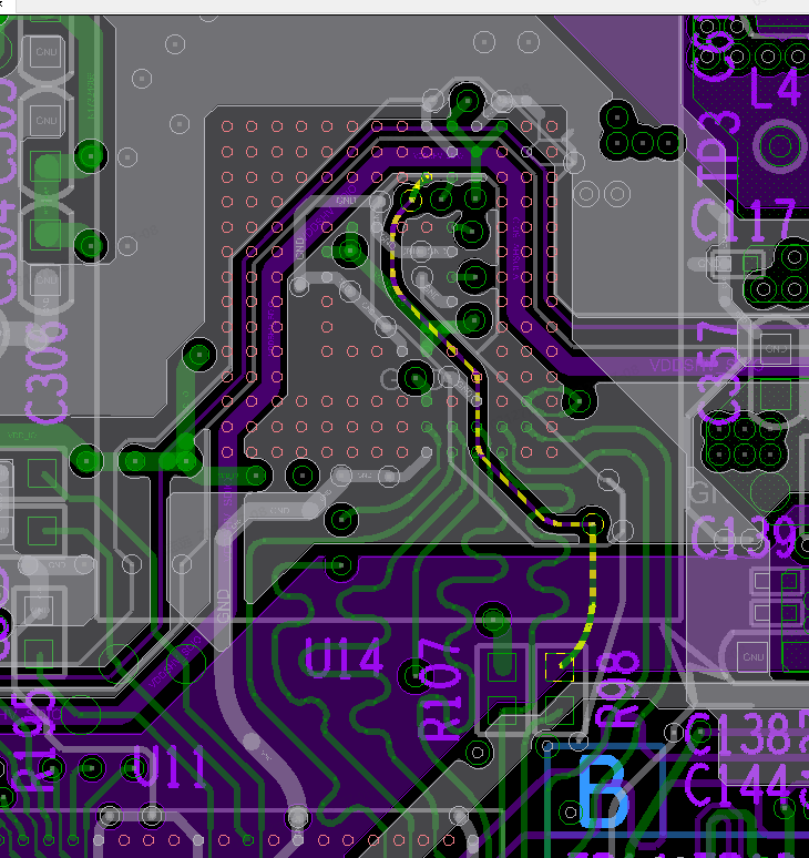

The layout route eMMC signals on top and layer 3, Layer 2 is GND. eMMC_CLK =715.04mil, impedance control 50+-5ohm.
Layer 3, eMMC_CLK highlighted
Signals was configured internal pull up in sysconfig:
Should lower layout impedance from 50ohm to 40ohm?
Need suggestion to improve the signal slew rate.
