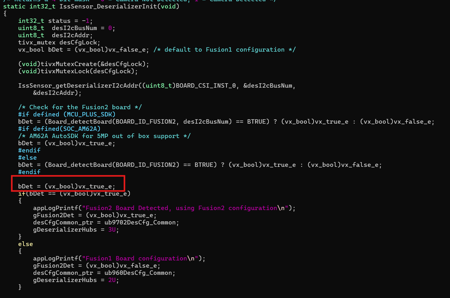

Hi TI Team,

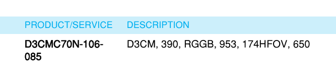

I have TDA4VEN EVK and fusion2 board and IMX390 cameras from D3, I tried the changes mentioned in the following e2e, i ran single cam app, it does not show any camera stream on the display, and shows many register write failures. Please let me know what else needs to be done to get the cameras working ?
https://e2e.ti.com/support/processors-group/processors/f/processors-forum/1575823/faq-j722sxh01evm-how-do-i-use-the-fusion2-board-with-the-j722sxh01evm
Below highlighted change I did and rebuilt and updated the sd card
